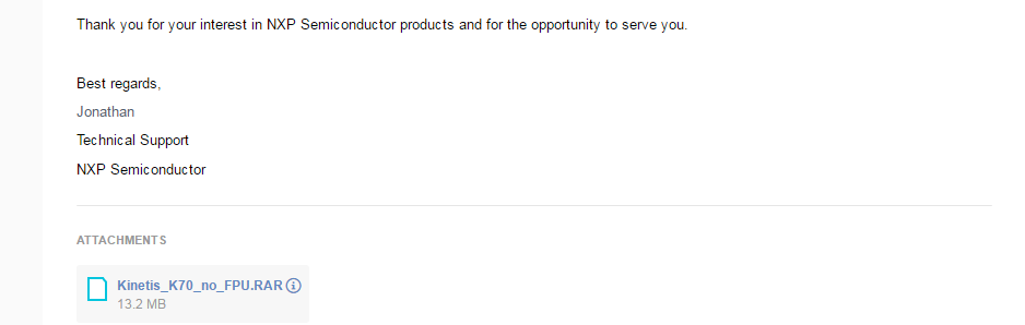

Dear Armend Gecaj,
there is not much information about your question, I found something that may work for you. it is a document from one of our engineers. she used a K70. here is a video from our engineer. see the attached file.
hope this works for you.

armendgecaj
Hi Jonathan
sorry i am late. Thank you for your help.
You wrote: "see the attached file". But their is no attached file.
Or did you mean the video?

Jonathan_Iglesias
Hello Armend, It is ok, yeah on the bottom of my last answer there is a .RAR file, and I found something With the K82F with the Ov7670 there is already a demo in the KSDK library for K82F, uses the camera as an extern camera like a webcam via USB in the next link there is a description about this demo in version 1.3 and there is one for 2.0.
FRDM-K82F FlexIO Camera Demo
