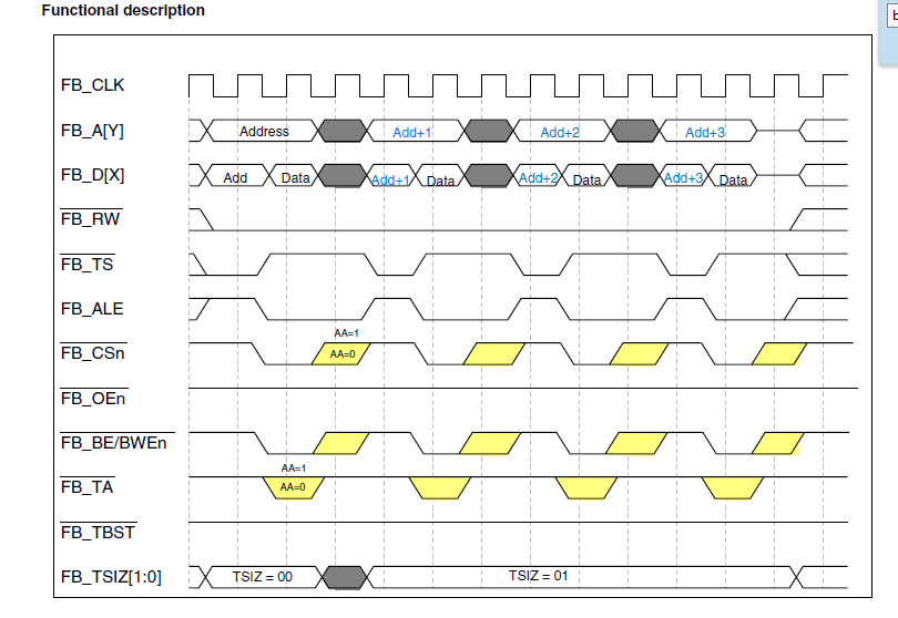

Hello, I have a question about the flexbus in Kinetis K64 controller. I'm using the flexbus in burst-inhibited mode for a 8 bits bus size. If I execute the 16 bits access  using the automatic acknowlege it works well, but if I use the FB_TA signal, the cycle is closed after read of first byte. A note: the second pulse of FB_ALE comes in any case but the second FB_CS0 pulse doesn't occurs. Have you some work around?

Thanks xiangjun.rong for you answer, but the K64 behavior isn't correct.
In my board the BUS_CLK signal isn't available between K64 and FPGA.
Inside FPGA I handle many DRams through a 16 bit communication device, so I use the FB_TA to close the cycle.
The access used is 16 bits burst-inhibited to 8-bit port, and the number of wait state is defined by FB_TA signal, but of course the wait states aren't the same at any access: it depends if at the other side of DPRam an access occurs at the same time.
The FB_TA assertion doesn't close the individual transfer, but it closes also the complete cycle (see 31.4.12.5 of K64 Sub-Family Reference Manual, Rev. 2, January 2014 picture page 778).
In attachment you can find pictures with the signals routed to test points by FPGA:
Legenda:
Channel 1 (orange): signal FB_CS0
Channel 2 (blue): signal FB_ALE
Channel 3 (purple): signal FB_TA
Channel 4 (green): signal FB_TSIZ1
Please see the two pictures without FB_TA connected and with FB_TA connected (AA=1).
Please note the presence of FB_ALE without FB_CS0 at the second transfer, when FB_TA is connected (second picture)
Thanks in advanced.

Do you use the FlexBus to access multiple DRAM or just SRAM, what is the function of FPGA? can you use multiple CSx to access the SRAM? If the K64 has enough CSx to access SRAM, you can use Auto-Acknowledge mode.
If you do use FB_TA to terminate the access, I still think you have to FB_CLK, because the rising edge of FB_CLK is used to sample the FB_TA signal, if your FPGA does not use FB_CLK, how do you synchronize the FB_TA with FB_CLK?
This is the timing of  32-bit-write burst-inhibited to 8-bit port described at 31.4.12.5.
BTW, the BSTR and BSTW bits should be cleared to disable burst mode.

1) The FPGA uses flexbus to access to a controller and other glue logic. The controller interfaces also internal dual port sram. For this reason the FB_TA answer time isn't always the same.
2) Yes, I have multiple CSx in FPGA interface. The access to controller use FB_CS0, but in spare pins are available also FB_CS2, FB_CS4 and FB_CS5.
3) Yes, I know. It's possible to use Auto-Acknowledge mode, but the access becomes slow at all cycles. Using  FB_TA the access is slow only when the bus at the other side of DPRAM executes an access at the same time.
4) No, the FB_CLK signal is not available in my FPGA. The FB_TA signal is sampled by K64. If the falling edge of FB_TA become at the same time of rising edge of FB_CLK, an additional wait state can be added. It isn't a problem.
i.e see item 4 at "2.1 Read cycle" of AN4393 Rev. 0, 05/2012.
Using the basic access, it works well without synchronize FB_TA with FB_CLK. It's normal for all bus async busses
5) Yes I disabled the burst mode clearing BSTR and BSTW flags.
Using only Auto-Acknowledge mode it's work well, but using FB_TA to close any single transfer it doesn't work.
Can you confirm this behaviour of K64?
It's strange because the FB_ALE signal is correctly asserted, but the FB_CS0 is not asserted (see pictures of last message).
Is it only a problem of FB_CS0 signal? Can I solve the problem substituting FB_CS0 with FB_CS2 (or FB_CS4 or FB_CS5)?

As a workaround, I recommend you use Auto-Acknowledge mode, you can connect CSx to each SRAM or memory-mapped devices, each CSx access timing can be set up independently,for each CSx has it's own FB_CSCRn.
Regarding your solution to terminate access with FB_TA, I think it is difficult to generte the FB_TA with FB_CLK involvement.
