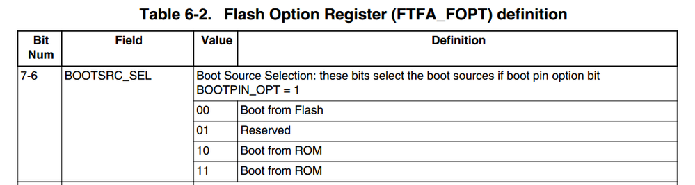

When KL43 chip with a blank flash, the Kinetis bootloader will execute automatically. Once the flash is programmed, the value of the FOPT field at Flash address0x40D will determine if the device boots the ROM bootloader or the user application in flash.

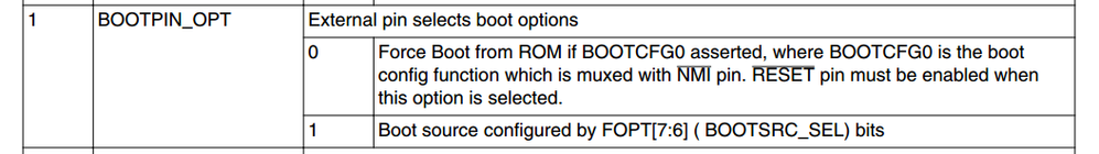

The FTFA_FOPT [BOOTSRC_SEL] will select if boot from customer application (Flash) or boot from ROM bootloader.
For example:
      When Flash address 0x40D value is 0xFF, boot source is ROM bootloader;
      When Flash address 0x40D value is 0x3D, boot source is Flash (Customer application).
There with hardware pin(/BOOTCFG0) to control if boot from user application or ROM bootloader with FTFA_FOPT[BOOTPIN_OPT] bit . When FTFA_FOPT[BOOTPIN_OPT]  = 0, it forces boot from ROM if /BOOTCFG0 pin set to 0.

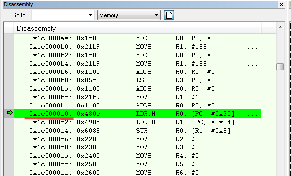

Customer could continue to debug the code until the ROM bootloader be called. If customer debug into the runBootloader(NULL) function, there will stop at fixed address: 0x1C00_00C0.
In fact, during call the ROM bootloader function , there will setting some parameters and then reset the KL43.
When KL43 back from reset, it will boot from ROM bootloader. That reset will cause debugger disconnect with the KL43 product.
