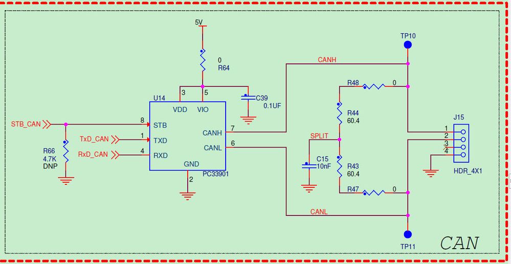

    Of course, my code works on the real canbus, not the loopback mode.
    If it works in the loopback mode, the data won't sent to the CAN bus, it will loopback through the chip internal pin circuit.
    My test result is from the J15, pin1,2, CANH and CANL, this is the ACTUAL canbus, not the loopback.
You also can test the wave from CANH and CANL: J15 pin1 and 2.

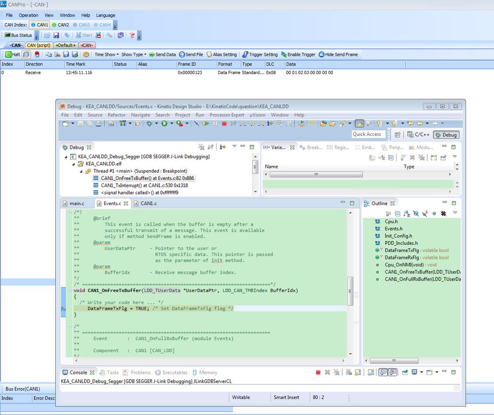

   You said, the interrupt are not called, I don't know whether you put an breakpoint in the PE_ISR(CAN1_TxInterrupt) or not?
If you put a breakpoint in the interrupt service code, you will find the interrupt is entered, just like the following test picture:
The above test result is from the CANBUS tools which connect to the KEA128 CANH and CANL in the CANBUS.

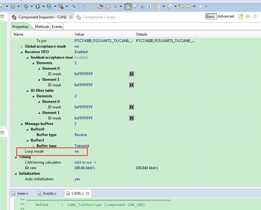

Take care, it is really not the loopback mode, if in loopback mode, the Loop mode in the CAN_LDD will be yes, but now, we configure it as no:
If you still have question, please let me know!

Give you a connect picture for your reference:
Wish it helps you!
Jingjing

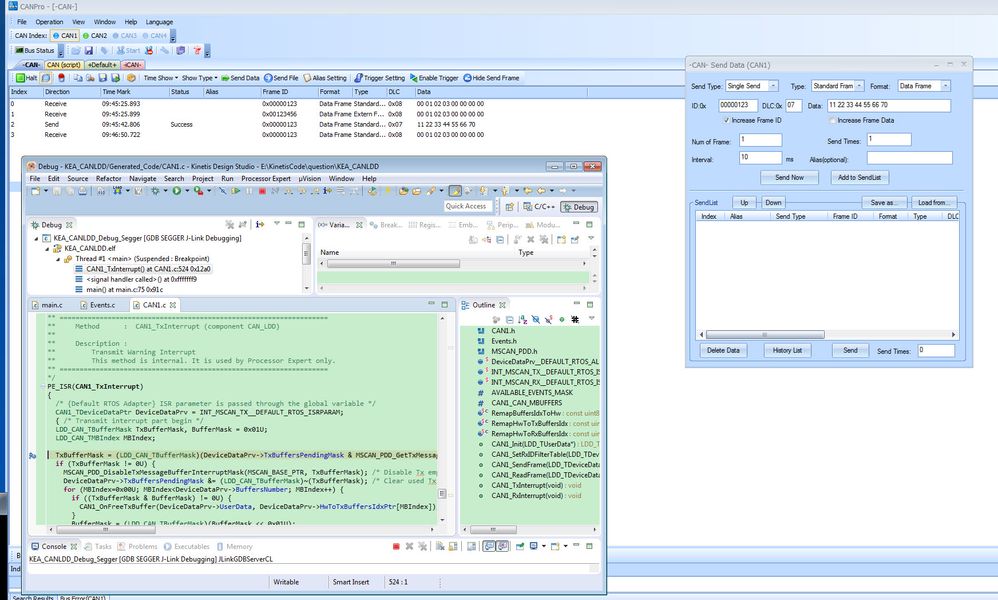

kerryzhou
Hi Michael Amici,
      I tried both TRK-KEA128 SCH-28200 REV B and SCH-28200 REV D, these two boards, are all working ok on my side.
     I have a question, did you connect any other CAN node in the CAN BUS, if you connect nothing in the CAN bus, of course, it won't enter in CAN1_OnFreeTxBuffer, because no other CAN node give feedback, it will have error, it won't send successfully.
    I have connect my CAN_BUS tool in the CAN bus which used as the CAN date analyzer, I can enter the CAN1_OnFreeTxBuffer function:
Please make sure you already add another CAN node in the CAN bus!
Wish it helps you!
