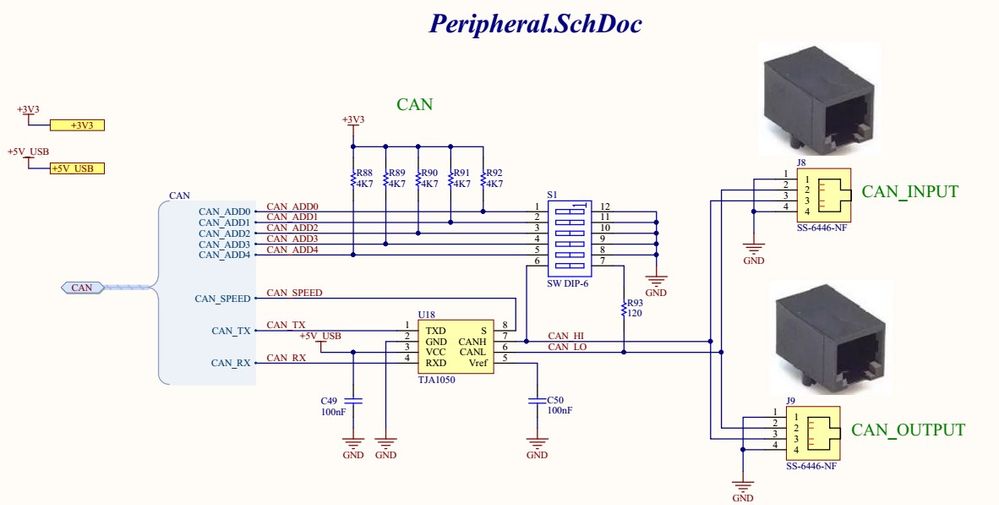

We are developing a motion control board using the below processor
K20DN512VLL10
I have pin 100, 98, 97,72, and 71 connected to a CAN transceiver (CAN address pin 0 - 4).  I also have pin 99, 42, and 43 connected to CAN transceiver (CAN_speed, CAN_TX, and CAN_RX).  There is also a DIP switch to set the CAN address.  Do you have any sample code for CAN communication on this chip?  What SDK is the best for this kind of development?  Thank you very much.
29 Replies
9,068 Views
kiemvo
It is Kinetis CAN peripheral.  You can see the schematic portion below.  The CAN I/O ports are connected to a switch and then to the MCU pins as describe above.

Thank you very much for the CAN links. The main task that we need to do right now us to provide CAN addressing using DIP switch and basic CAN communication. Since we are new to CAN bus, what are the appropriate steps and recommendations?

Since you have a 5 bit DIP switch on your board you can only set 5 of the 11 or (extended addressing mode) 18 bits so you will need to define what address range or which masks you use with this. Based on the DIP switch value you can set the rx ID and its mask as appropriate and receive and CAN message addressed to it.
Eg. of setting a unique extended address and starting operation would be something like:
    unsigned char ucID = fnReadDIP(); // get 5 bits of ID
    ucID |= 0x26c0;                   // add fixed bits
    CANTABLE tCANParameters;                                             // table for passing information to driver
    tCANParameters.ulRxID = (CAN_EXTENDED_ID | ucID);                    // our ID (extended)
    tCANParameters.ulRxIDMask = CAN_EXTENDED_MASK;
    CAN_interface_ID0 = fnOpen(TYPE_CAN, FOR_I_O, &tCANParameters);      // open interface
Each time a message is received for the ID there is an event called CAN_RX_MSG which is handled by
Length = fnRead(CAN_interface_ID0, ucInputMessage, (GET_CAN_RX_TIME_STAMP | GET_CAN_RX_ID)); // read received CAN message
This places the ID of the transmitter, the message time stamp, plus the message content into the buffer ucInputMessage, which can then be processed accordingly.
You can see this in operation in the video.

We have implemented CAN bus.  However, we have an issue.  The CAN master keeps sending out messages (we probed and saw the waveform on Oscilloscope), but the slave nodes cannot receive or respond.  We also probed CAN-H and CAN-L pins of the slave and saw the exact waveform, but the slaves take no actions.  In the meantime, it seems to us that the sending function had issue with interruption (it could not get out the critical session).  My co-worker has also posted the question here https://community.nxp.com/message/866758 .  Any helps will be greatly appreciate.
9,064 Views
mjbcswitzerland
Specialist V
Hi Kiem
Unfortunately I can't really help with PE generated code - possibly it is not correctly mapping the interrupt ID to match the chip you use?
Take a look at the uTasker project that you received to see how it does it (you can also check the operation in VisualStudio without need for HW).
Mark
9,064 Views
kiemvo
Thanks a lot for all your advice and suggestions.  The problem was about the cable we used.  It has twisted wires inside.  Problem is now solved.

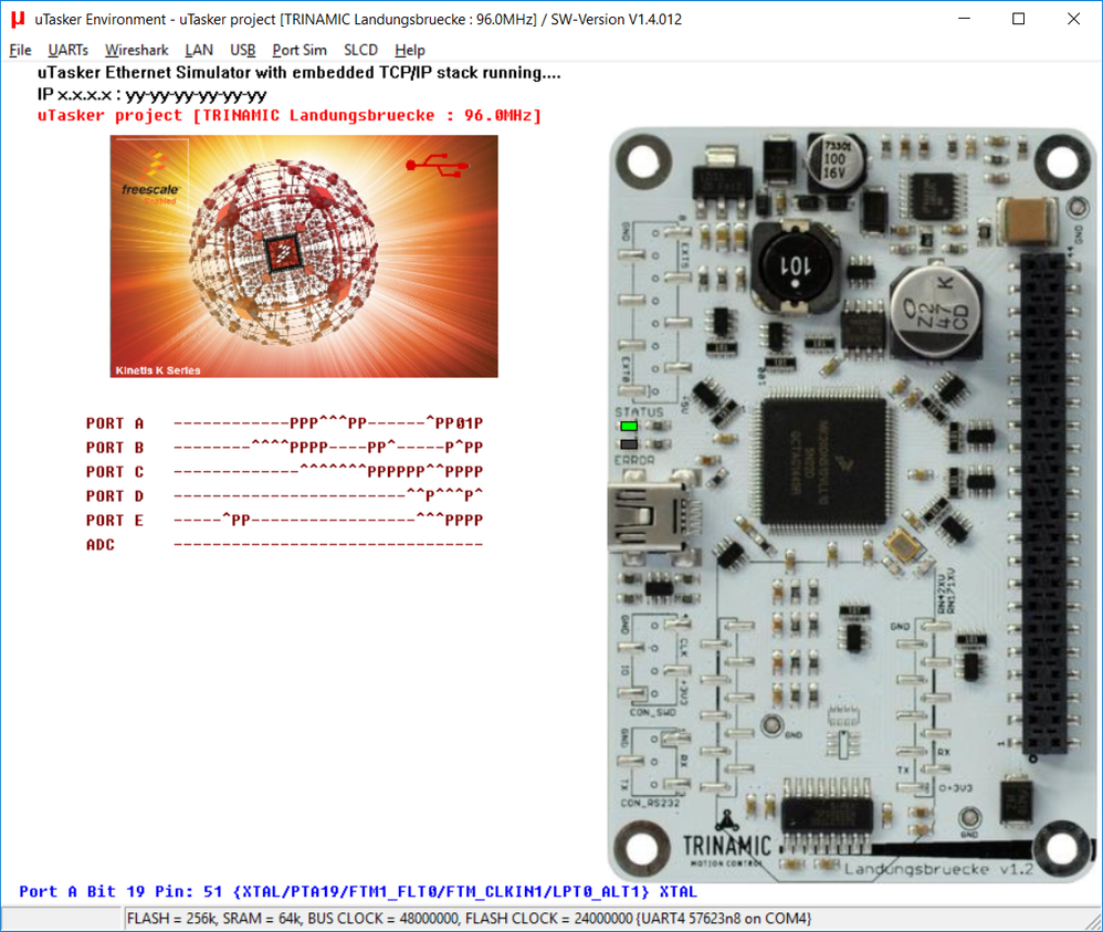

Wow. Thanks for the quick response. Our firmware is based on Trinamic (see below). Would the utasker code can be ported in easily based on your experience? Have a good day.
http://www.trinamic.com/support/eval-kits/eval-kits/landungsbruecke
Kiem
9,069 Views
mjbcswitzerland
Specialist V
Hi Kiem
The uTasker project works immediately on almost any Kinetis (K, KL, KE, KEA, KV, KM etc.) and can be ported to any board within few minutes.
I just set up a "TRINAMIC Landungsbrücke" target (see above) but couldn't complete it immediately due to the fact that the evaluation board is not correctly supported on the TRINAMIC web site - it gives you an STM32 based circuit diagram instead.... I see that the boards are obtainable at Digikey but are not that cheap. I therefore wonder why you chose this board and whether it is in fact used by anyone else?
I wrote to TRINAMIC to point out that the circuits are incorrect and also that they spell "Fresscale" incorrectly but got an automated response that technical support is only possibly via a ticketing system at a certain link. The link pointed to a dead page and on the web site there only mention of an old ticketing system that seems to no longer be offered. However I did later receive a response with the correct set diagrams and so have completed it in the meantime. Note that the chip on the board is the K20DX256VLL10 and not K20DN512VLL10!
Mark
