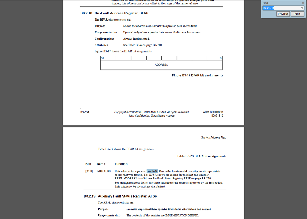

bjoernjohanness
Norm, I really appreciate your input :smileygrin: I have something similar in my SW.
The problem here is that this behavior (Bus Fault) is undocumented and has no flags indicating the source of the fault. There's no explicit flag to clear, hence when I try to return from the exception handler the Bus Fault is still active and I end up back in the exception handler :smileysad:
The BFAR register hints at the source but doesn't explicitly tell me that the flash is corrupt and won't allow me to clear the source of the Bus Fault so I can return.
//bjoern

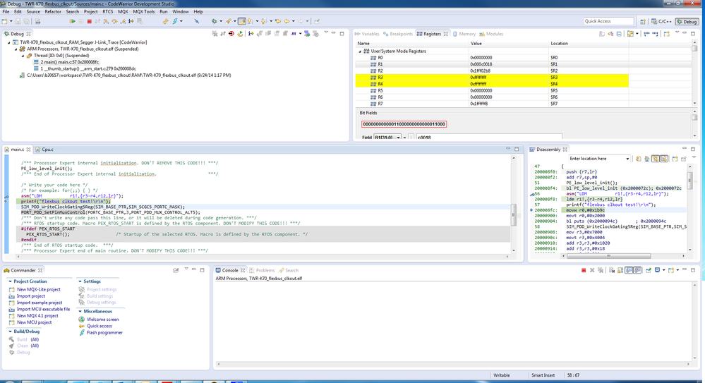

DavidS
Hi Bjoern,
I have found looking at the IPSR and ICSR registers helpful when you can set a breakpoint in your exception routine.
What debugger tool are you using?
Can you set a breakpoint in the exception routine?
Can you look at the callstack and go "backwards" to see what routine and "C" code specifically was trying to execute?
Are you running MQX or baremetal code or other?
What hardware are you running on?
The more you can show the better we can understand the issue.
David
31,611 Views

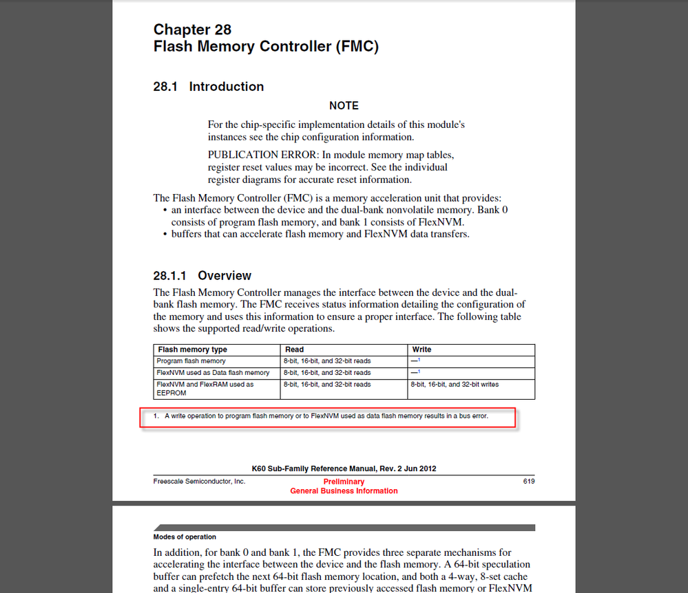

bjoernjohanness
Hi David, thanks for replying!
I agree those registers are good, if you look at my initial post those are in my crash-report :smileyhappy: Unfortunately there's nothing indicating the source of the bus fault and that is also my issue (I mean I know it's caused by reading from internal flash but there's no flag explicitly indicating that).
Yes I can easily catch it in the exception handler, the routine that's causing the bus fault is memcpy(). The root cause is reading from internal flash address 0x1C0010 which I've corrupted on purpose. No-where can I find anything saying that reading internal flash could EVER cause a Bus Fault.
It shouldn't matter in regards to my issue but my board is similar design to Tower K70, running modified Quadros RTOS and I use uVision.

Kan_Li
Hi Bjoern,
The spec I was referring to is the RM, you may find the following statement in the chapter for FMC:
and when bus fault happens, you may find the reason and address info in the regiters from ARM Cortex M4 core, please refer to the following for details.
Hope that helps,
Kan

bjoernjohanness
Kan,
Thanks for clarifying the reference :smileyhappy: and pointing out BFAR.
From RM: "A write operation to program flash memory or to FlexNVM used as data flash memory results in a bus error"
=> That reference only talks about write-operations to the flash, right? Actually, it's not really related to my read-operation causing a Bus Fault but instead pointing out that you can't perform write-operations to flash.
No-where can I find anything saying that reading internal flash could EVER cause a Bus Fault. This is undocumented behavior and there's no flag anywhere indicating what caused the Bus Fault, possibly one could argue BFAR is hinting at it implicitly.
//bjoern
