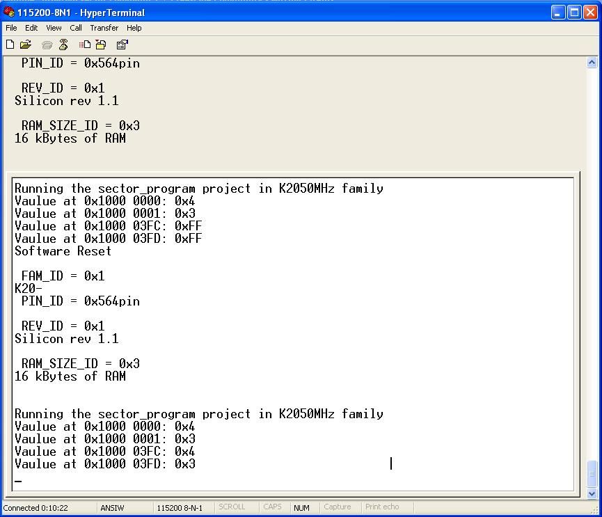

I wrote a little test program to test the Flash Memory Module "program sector command".
To test it, I use a K20 tower board. The K20 tower board has got 256kByte of P-Flash, 32kByte FlexNVM (D-Flash) and 2kByte FlexRam.
The sector size is:
2kByte for P-Flash
1kByte for D-Flash
The program sector command allows to use half the FlexRam to program Flash memory. One just fills the under half of the flexRam and launches the progam sector command.
Thats what I'm doing in the following code. I fill the under half of the FlexRam (1kByte) with a test pattern and launch the command. The strange thing is, that the last byte keeps unprogrammed. Only 1023 byte are programmed and the last one keeps erased (0xFF).
This is not a real problem but i'm interessted if i'm doing a misstake or if it is a bug. Maybe someone can help me :smileyhappy:

Since you want to progam 1024 bytes, which is 256 longwords, so you have to set
FTFL->FCCOB4 = 0x01;// Nummber of longwords to program (0x0100)
FTFL->FCCOB5 = 0x00;
I also tested it with this change based on TWR-K20D50M, the result is as below.
Please kindly refer to the attached project for more details.
Hope that helps,
