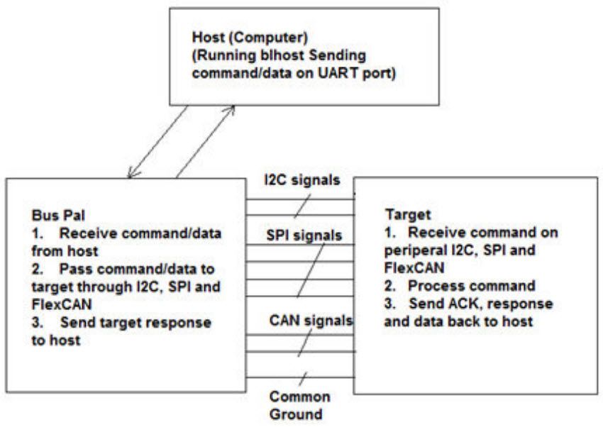

While attempting to write to FLASH during an update via I2C (in BSL mode) the process was interrupted.  When this happens, the Microcontroller will no longer respond to any bootloader commands via I2C.  The only recovery is through the emulator.  Is there a method by which we can get the micro to respond and restart the process?  We're working with the MKL03Z32CAF4R device.

The KBOOT has provided the BusPal as a companion to Blhost and the KL03 is allow to be reprogrammed through the I2C interface by using the BusPal to interface Blhost and target device as the Fig 1 shows.
                                                                       Fig 1
So I was confused with the interrupt happening, obviously the target device can't arise any interrupts while the target enter the Bootloader mode.
Can you explain it please?

When I said interrupted, I meant we were in process of writing to memory (after flash erase all) and the transfer did not complete.  So, the transfer did not write a full image to flash before it was stopped, either by the user, or maybe even a power failure.  Once we reset power, we can no longer communicate with the bsl.
