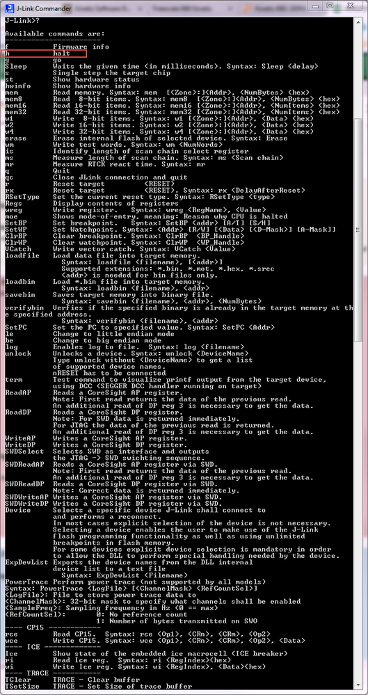

I am trying to erase the device flash with J-link lite, but there is a problem that the MCU is running and the J-link commander can´t halt them.
Don´t you know how to stop (halt) it?..
4,708 Views
ivadorazinova
Yes. For that you can use J-link Commander.
With symbol "?" list the table of commands.
or you can go to table (p. 64, 69) at User Guide for J-Link https://www.segger.com/cms/admin/uploads/productDocs/UM08001_JLink.pdf
