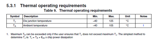

Dear Wayne(Wang Peng),
Do you know where the maximum of Tj for KE04 can be found?
For example, in the S08PA:
Thanks for your help.
B.R.
Moris Hsu

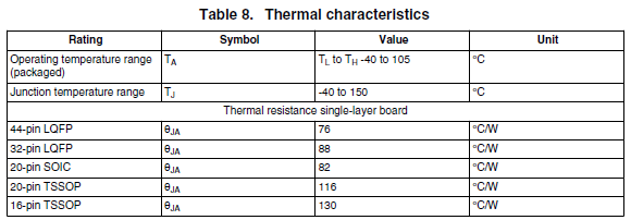

please refer to below table, will update KE04 datasheet soon.
