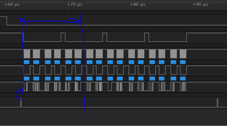

I have used AD7770s with Kinetis for multiple 24 bit inputs via SPI and personally I would be tempted to use something like this - sleep as long as possible between interrupts, get the data, check levels and store as quickly as possible and sleep as soon as possible again. There are various factors affecting current consumption including of course the run speed which can also be fairly slow to do the work, until triggered, after which it can switch to full speed.
Here is a recording of the SPI bus to an 8 channel 24 bit AD7770 reading via SPI, whereby in this case it is one of two such buses being read in parallel. It is not super- efficient since during the actual SPI transfers the processor is also doing some floating point scaling and other processing on-the-fly (in parallel) which doesn't merit fastest possible transfers but is can be seen that you are looking at maybe 3..6us of activity (with tighter SPI timing) each sample and the rest of the time the processor will (depending on exactly which low power mode is most suitable) be consuming hopefully little current.
Since the FlexBus of the K24 is a bus slave I doubt that it is possible to write to SRAM (which is also a bus slave in the K24) from an external device.
The internal ADCs can't write to SRAM themselves, they either need the CPU to do the transfer or DMA, whereby in low leakage modes such activity is generally not possible since they are also sleeping.
