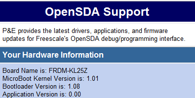

rogerzhong
The firmware of OpenSDA consists of three parts: MicroBoot, Bootloader and user app. Bootloader and user app can be updated separately. After powered-on, the MK20 enter the MicroBoot and to check if there is a update file existed, if yes, update the Bootloader; or, execute the Bootloader. The bootloader acts a similar role as Microboot to choose update the user app part or run the user app directly.
The following screenshot shows the version of each part.
:smileyhappy:
