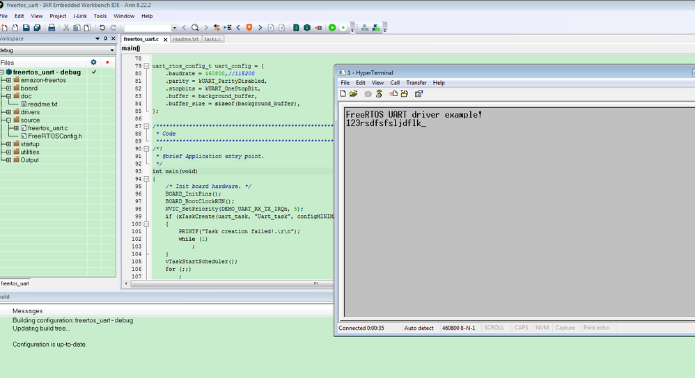

kerryzhou
Hi Simon,
   Sorry for my later reply!
   Today, I have tested the SDK_2.4.2_FRDM-K64F\boards\frdmk64f\rtos_examples\freertos_uart\iar
Change the baudrate to 460800 bps, then test it as follows:
You can find, FRDM-K64 can receive the input data and output it back.
Kerry

simonhaines
Thanks Kerry, I think I was being over-ambitious with how much the Kinetis UARTs can handle. Multiple peripherals on 460800 baud will cause Rx overrun, even at 120MHz.
