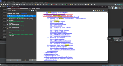

Hi @randyseedle,
You use the keyword asm to embed assembler instructions within C code.
You can find how to use this feature on the Help menu of MCUXpresso -> Help contents and search for "inline assembly"
Pablo
