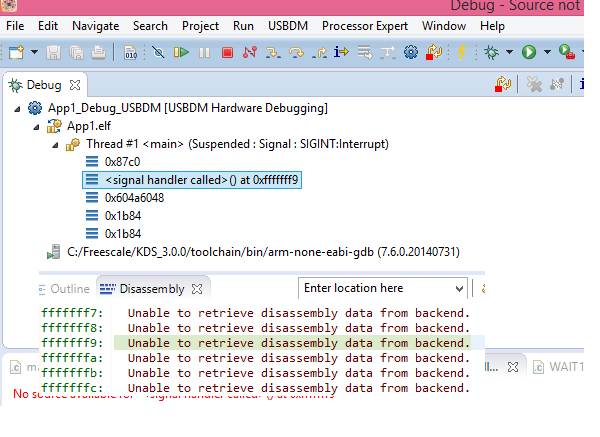

CCandido
Contributor V
Hi Hui_Ma,
See code source, other code normal error, I creat simple test = error , when use ISR in App2.
void main_run (void){   // App1
uint32 i=0,x=0,_addr, _stackp;
byte asc=0;
BL_FLASH1 = FLASH1_Init( &OpStatus); // init Flash
WAIT1_Waitms(1);
                       while( asc != 'N'){               // wait end table
UTIL1_strcpy(in_buffer,46,app2_hex[x++] );  // Copy App2 ( Hex, charged table )
asc = in_buffer[0];
if( asc != 'N' ){
convert_line_hex();  // convert hex ascii to Hex value
status_flash_busy();
i = FLASH1_Write( BL_FLASH1, my_hexline.HEX_linedata,
                               my_hexline.hex_addr,
                                 my_hexline.hex_count);            //program App2 in flash memory
WAIT1_Waitms(5);
                     x=0;
                          for(;;){
                               if( x == 9){ // insert value 9, to goto App2
                             _stackp = ( *(( unsigned long*)&MEMBASE + 0));        /// BASE = 0x8000
              _addr = ( *(( unsigned long*)&MEMBASE + 0x6E));    // BASE + 0x6E = address direct entry pointer main_run
                              // SCB_VTOR = 0x8000; // vector in fash_0x8000
                                 reloked_vector(); // vector in ram_0x1FFF8000
                                JumpToUserApplication( _stackp , _addr );
                           x=0;
                 WAIT1_Waitms(1000);
               LED1_Neg();
//----------------------------------------------------- see debug
thanks,
Carlos
6,447 Views

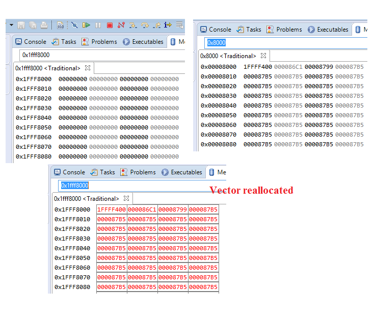

Hui_Ma
The below code doesn't copy APP2 vector table from 0x8000 to SRAM 0x1FFF8000.
When the interrupt happens in APP2, the SRAM 0x1FFF8000 without correct vector table to load related interrupt service routine.
Wish it helps.
Ma Hui
6,447 Views
CCandido
Contributor V
Hi Hui_Ma,
please open code source see code:
#define MEMBASE *(( unsigned long*)0x00008000)
void reloked_vector (void){ // <------ copy vector 0x8000 to 0x1FFF8000
int i;
                  for(i=0 ; i< 0x6E; i++){
*((volatile unsigned long*)(&__vect_table_ram) + i )= ( *(( unsigned long*)&MEMBASE + i ));
                                    SCB_VTOR = (uint32)( &__vect_table_ram);
thanks,
Carlos.
6,447 Views
