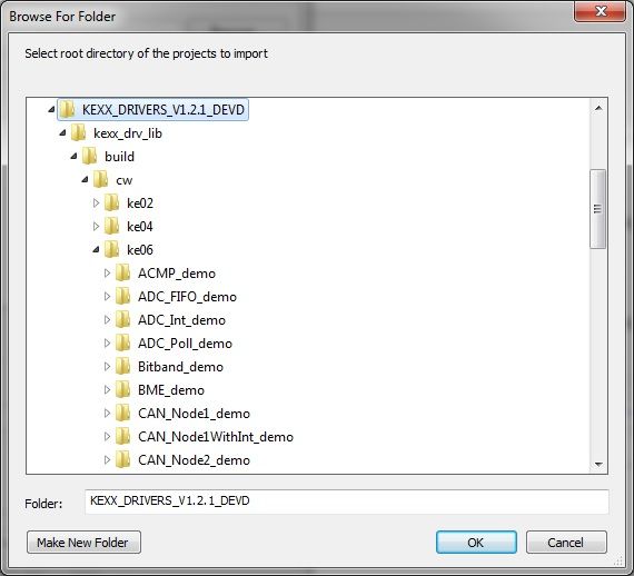

Also, if you are looking for CAN demo software, visit the FRDM-KE06Z webpage.  On the Downloads tab you should find a link for "KEXX_DRIVERS_V1.2.1_DEVD".
In this package there are CAN demo projects for the FRDM-KE06.  You'll need to populate the 0.100"C CAN header J11 on each board, then connect them with a cable.  You could also solder wires directly if you don't have headers and a cable.
I have used the CAN_Node1WithInt_demo for one Freedom board and CAN_Node2_demo for another Freedom board.  This combination works out of the box and will send CAN data between the two Freedom boards.  The CAN message for to/from each Freedom board can be monitored through the OpenSDA comm ports and a serial port program.

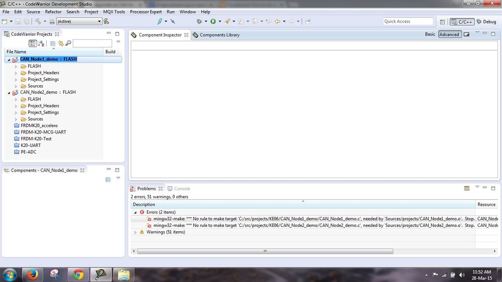

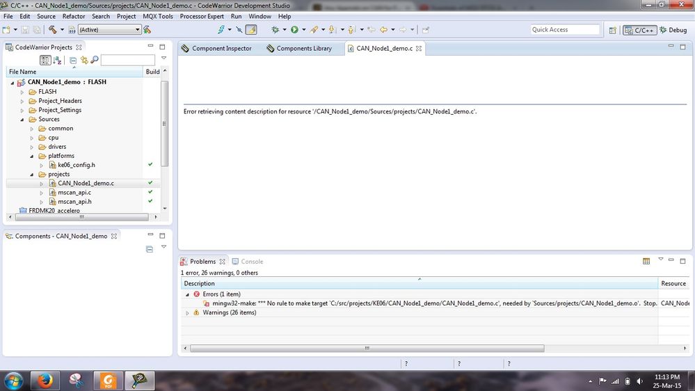

Hi Norman
The project was not opening in CW 10.6 when I tried importing the project. Can You please confirm if I imported the correct files ?
I cleaned the project and then tried to build it. But it didn't work. Please correct me to make it work. Thanks in advance.

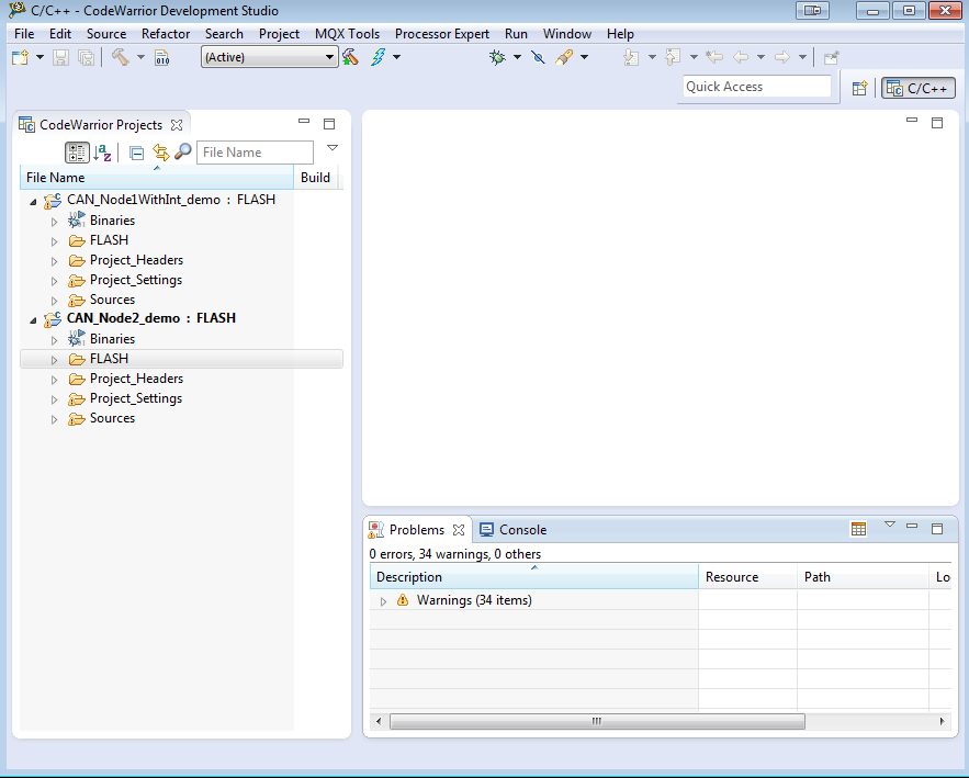

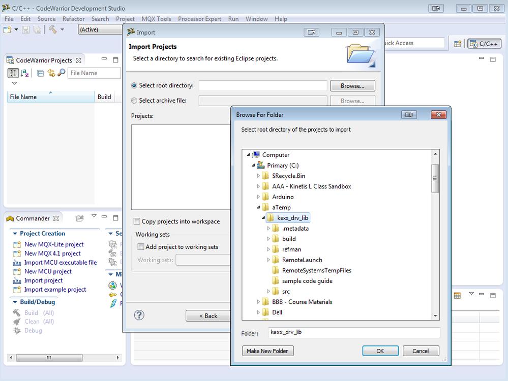

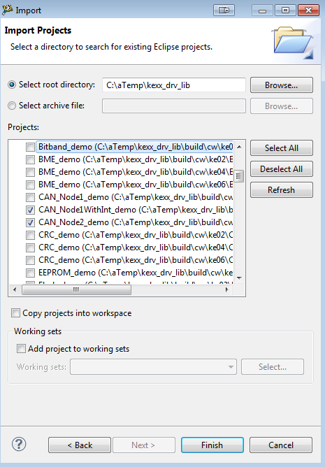

Hi Amit,
I set my workspace to the location where I extracted the files to - in my case C:\atemp\kexx_drv_lib.  I then used the import wizard to select the two CAN projects (see screen captures).  For me, both projects built without errors (there were some warnings, though).
Hope this helps!

Hi Norman
I followed your way but still I am getting the same issues on both the projects.....
Can you attach the project you have build.
