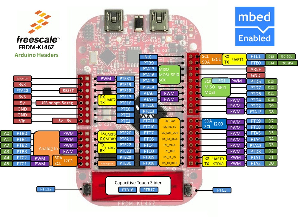

I suggest you to remap I2C0 bus pins from pins PTE24/25 to I2C1 bus pins PTC1/2 and write and debug "Reset I2C" routine by scope. When finished remap pins back to I2C0 and use it. The I2C1 pins are available on the board header.

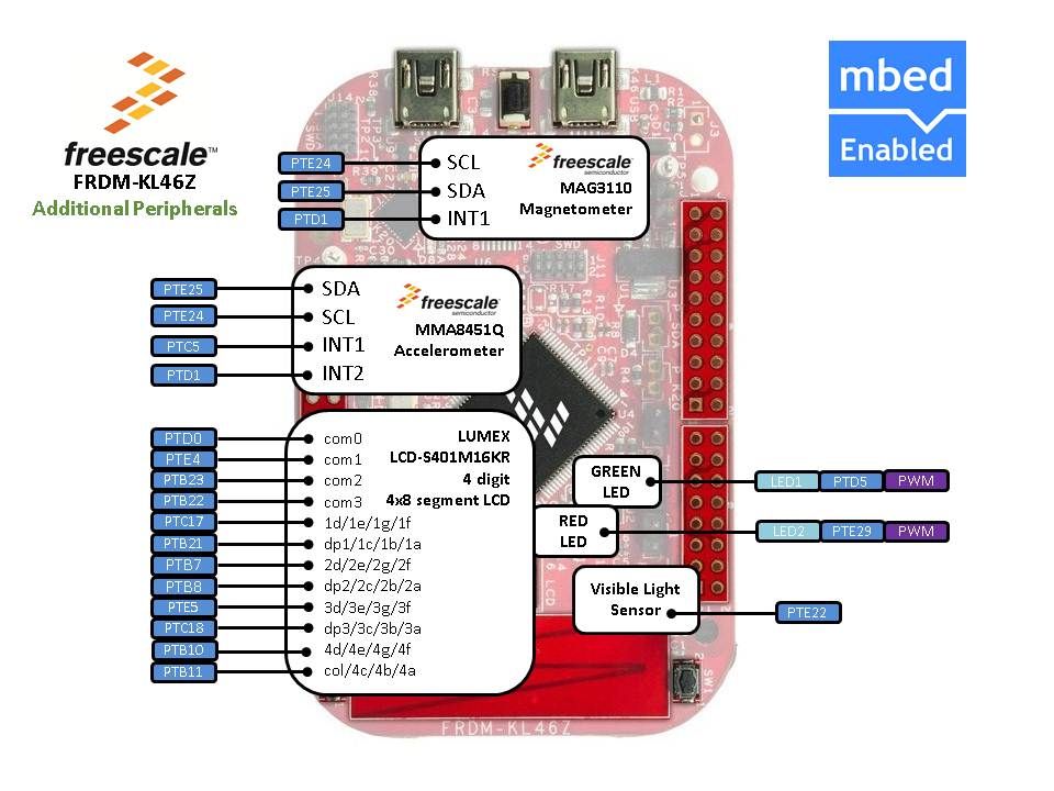

Unfortunately, the pins that the SCL and SDA lines of MAG3110 are connected (PTE24 AND PTE25 respectively) are not available to me for connection on the board externally(see PIN map attached). Thus, I'm not able to give the required sequence on the pins or use the logic analyzer. Any workaround to the issue?

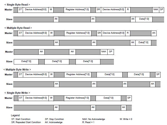

amanjain
When I send the device address on the I2C bus after a start, I should get an acknowledge signal on the bus, but I do not receive any acknowledge signal. I am using the device address for MAG3110 as 0x0E. Assuming the bus clock as 24MHz, baud is set to 100kHz. The RXAK bit in Status register of I2C0 is always set when I read it(It should be cleared when I2C receives an acknowledge signal).
Attaching my code for I2C setup as well.

kerryzhou
Hi Aman Jain,
      MAG3110 is just the I2C slave device, it just receive the baud, if the I2C baud is under the max baud, the MAG3110 hardware can receive, you don't need to care it, just keep the master I2C baud at the I2C baud range which MAG32110 can receive.
  About the communication is failed,  MAG3110 is NACK, please use the logic analyzer to capture the I2C wave, whether it is correct, whether the Address is sent correct.

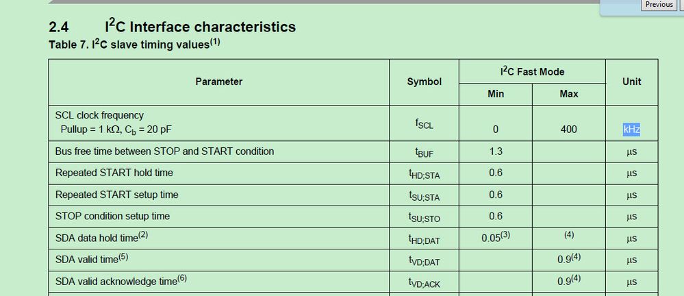

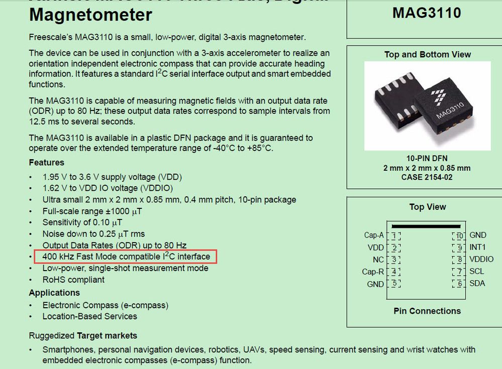

kerryzhou
Hi Aman Jain,
      From the MAG3110 datasheet, you will get that the max I2C baud is 400Khz:
400Khz is the max baudrate, you can use the lower baudrate, eg,10Khz, 50khz, 100khz. etc.
About the bus clock in the microcontroller, it is determined by the system clock which you are configure.
If you don't configure it, and just use the internal slow IRC 32.768khz, the bus clock is 20.97152Mhz.
