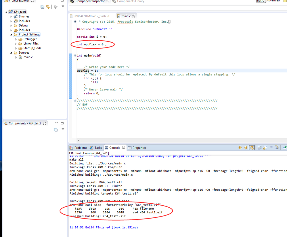

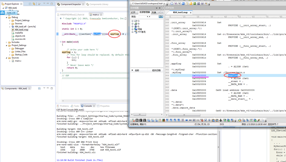

2.Refer to your information, I define a flag "appFlag", then relocate it into
0x20000. please have a look at my attachment demo. After build ,from the "k64_test1.map"
file , we can see the flash at 0x20000:
Also there is no change about the code size , below is the original one:
Hope it helps
