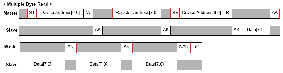

Understanding the Kinetis I2C peripheral module
Before getting into the specifics of creating a DMA enabled I2C driver, it is important to understand some basics of the Kinetis I2C peripheral module.  This module handles a lot of the low-level timing.  However the I2C registers must be serviced in a timely manner to operate correctly.  Take the case of a master reading data from a typical I2C sensor as shown in the diagram below.
In the diagram above, the red lines indicate points in the transaction where software or DMA needs to interact with the I2C peripheral to ensure the transaction happens correctly.  To begin a transaction the core must change the MST bit which puts a start bit on the bus (marked by symbol ST).  Immediately following this, the core should then also write the target slave's address (Device Address) including the read/write bit (R/W).  Once this transaction is complete, the I2C will issue an interrupt and then the core should write the register address to be read from. Upon completion of that being put on the bus, the I2C will issue another interrupt and the master should then put a repeated start (SR) on the bus as well as the slave's address again.  Now the slave will send data to the master (once the master begins the transaction by issuing a dummy read of the I2C data register).  In the standard configuration, the I2C peripheral will automatically send the NAK or AK depending on the configuration of the TXAK bit in the I2C peripheral.  Because of this automation, it is important that this bit be handled properly and is configured one frame in advance. Furthermore, to ensure that the NAK bit is sent at the appropriate time, the TXAK bit must be set when the second to last byte is received.  The timing of this configuration change is very important to ensuring that the transaction happens properly.
This document will describe how to use DMA to receive the data.  The DMA will be configured before the transaction begins and will be used to receive the data from the slave.  The document will also discuss options to handle proper NAK'ing of the data to end the transaction.

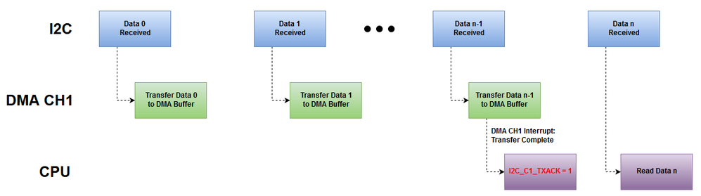

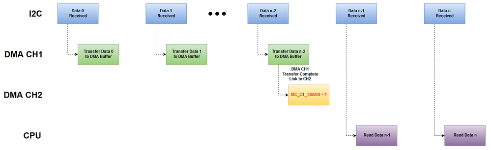

  1. A second dedicated DMA channel can be linked to write the I2C_C1 register every time the I2C_D register is serviced.  This option will require a second array to hold the appropriate values to be written to the I2C_C1 register.  The following figure illustrates this process.Case_1 (002).png
  2. The second DMA channel can be linked to write the I2C_C1 register after the second to last data byte has been received.  This option would require that the primary DMA channel be set to receive two data bytes less than the total number of desired data bytes.  The primary DMA channel would also need to be re-configured to receive the last two bytes (or the application software would need to handle this).  However this could be a desirable programming path for applications that are memory constrained as it reduces the amount of memory necessary for your application.Case_2 (002).png
  3. The primary DMA channel can be set to receive two data bytes less than the total number of desired data bytes and the core (application software) can handle the reception of the last two bytes.  This would be a desirable option for those looking for a simpler solution but has the drawback that in a system where the core is already handling many other tasks, there may still be issues with writing the TXAK bit on time. Case_3 (002).png

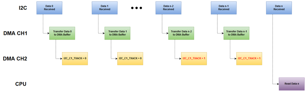

This example will focus on option number 1, as this is the simplest, fully automatic solution.  It could also easily be modified to fit the second option as the programmer would simply need to change the number of bytes to receive by the primary DMA and add some reconfiguration information in the interrupt to service the primary DMA channel.
DMA Channel #1
The first DMA channel is configured to perform 8-bit  transfers from the I2C data register (I2C_D) to the buffer to hold the desired data.  This channel should transfer the number of desired bytes minus one.  The final byte will be received by the core.  Other DMA configuration bits that are important to set are the cycle steal bit, disable request bit, peripheral request bit (ERQ), interrupt on completion of transfer (EINT), and destination increment (DINC).  It also important to configure the link channel control to perform a link to channel LCH1 after each cycle-steal transfer and LCH1 should be configured for the channel that will transfer from memory to the I2C control register (I2C_C1).  The first DMA channel is configured as shown below.

DMA Channel #2
The second DMA channel, which is the linked channel, should be configured to perform 8-bit transfers that transfer data from an array in memory (titled ack_nak_array in this example) to the I2C control register (I2C_C1).  This channel should also disables requests upon completion of the entire transfer, and enable the cycle-steal mode.  In this channel, the source should be incremented (as opposed to the destination as in the first channel). This channel is configured as shown below:

Finally, the DMA initialization function also initializes the ack_nak_array.  This is only necessary when implementing the first DMA strategy.  The second DMA strategy would only need to write a single value at the correct time.  The array initialization for strategy #1 is shown below.  Note that the values written to the array are 0xA1 plus the appropriate value of the TXAK bit.  By writing 0xA1, it is ensured that the I2C module will be enabled in master mode with the DMA enable bit set.
// Initialize Ack/Nak array
      // Need to initialize the Ack/Nak buffer first
      for( j=0; j < destArraySize; j++)
          if(j >= (destArraySize - 2))
              ack_nak_array[j] = 0xA1 | I2C_C1_TXAK_MASK;
          else
              ack_nak_array[j] = 0xA1 & (~I2C_C1_TXAK_MASK);
