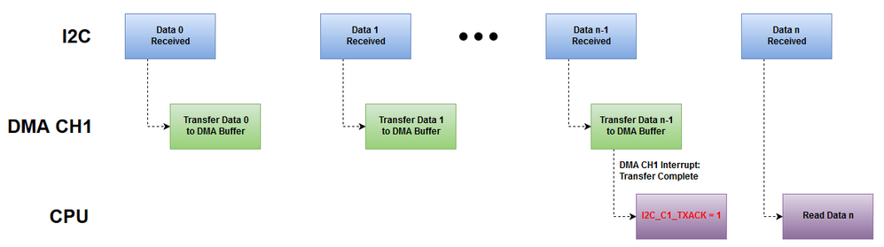

Understanding the Kinetis I2C peripheral module
Before getting into the specifics of creating a DMA enabled I2C driver, it is important to understand some basics of the Kinetis I2C peripheral module.  This module handles a lot of the low-level timing.  However the I2C registers must be serviced in a timely manner to operate correctly.  Take the case of a master reading data from a typical I2C sensor as shown in the diagram below.
In the diagram above, the red lines indicate points in the transaction where software or DMA needs to interact with the I2C peripheral to ensure the transaction happens correctly.  To begin a transaction the core must change the MST bit which puts a start bit on the bus (marked by symbol ST).  Immediately following this, the core should then also write the target slave's address (Device Address) including the read/write bit (R/W).  Once this transaction is complete, the I2C will issue an interrupt and then the core should write the register address to be read from. Upon completion of that being put on the bus, the I2C will issue another interrupt and the master should then put a repeated start (SR) on the bus as well as the slave's address again.  Now the slave will send data to the master (once the master begins the transaction by issuing a dummy read of the I2C data register).  In the standard configuration, the I2C peripheral will automatically send the NAK or AK depending on the configuration of the TXAK bit in the I2C peripheral.  Because of this automation, it is important that this bit be handled properly and is configured one frame in advance. Furthermore, to ensure that the NAK bit is sent at the appropriate time, the TXAK bit must be set when the second to last byte is received.  The timing of this configuration change is very important to ensuring that the transaction happens properly.
This document will describe how to use DMA to receive the data.  The DMA will be configured before the transaction begins and will be used to receive the data from the slave.  The document will also discuss options to handle proper NAK'ing of the data to end the transaction.

Next, the application layer needs a function to configure the DMA properly, and a DMA callback is needed to properly service the DMA interrupt that will be used as well as post a semaphore. But before diving into the specifics of that, it is important to discuss the overall strategy of using the DMA in this particular application. After every transaction, the data register must be serviced to ensure that all of the necessary data is received.  One DMA channel can easily be assigned to service this activity.  After the reception of the second to last data byte, the TXAK bit must be written with a '1' to ensure that the NAK is put on the bus at the appropriate time. This is a little trickier to do.  There are three options:
  1. A second dedicated DMA channel can be linked to write the I2C_C1 register every time the I2C_D register is serviced.  This option will require a second array to hold the appropriate values to be written to the I2C_C1 register.  The following figure illustrates this process.Case_1 (002).png
  2. The second DMA channel can be linked to write the I2C_C1 register after the second to last data byte has been received.  This option would require that the primary DMA channel be set to receive two data bytes less than the total number of desired data bytes.  The primary DMA channel would also need to be re-configured to receive the last two bytes (or the application software would need to handle this).  However this could be a desirable programming path for applications that are memory constrained as it reduces the amount of memory necessary for your application.Case_2 (002).png
  3. The primary DMA channel can be set to receive two data bytes less than the total number of desired data bytes and the core (application software) can handle the reception of the last two bytes.  This would be a desirable option for those looking for a simpler solution but has the drawback that in a system where the core is already handling many other tasks, there may still be issues with writing the TXAK bit on time. Case_3 (002).png
This example will focus on option number 1, as this is the simplest, fully automatic solution.  It could also easily be modified to fit the second option as the programmer would simply need to change the number of bytes to receive by the primary DMA and add some reconfiguration information in the interrupt to service the primary DMA channel.

To summarize, as consumers demand more and more power efficient technology with more and more functionality, MCU product developers need to cram more functionality in small power efficient MCUs.  Relying on DMA for basic data transfers is one good way to improve performance of smaller power efficient MCUs with a single core. This can be particularly useful in applications where an MCU needs to pull information from and I2C sensor.  To do this, there are three methods of implementing an I2C master receive function in your SDK 1.3 based application.
  1. Use two DMA channels.  The first to transfer from the I2C Data register to the destination array.  A second dedicated DMA channel can be linked to write the I2C_C1 register every time the I2C_D register is serviced.
  2. Use two DMA channels.  The first to transfer from the I2C Data register to the destination array. The second DMA channel can be linked to write the I2C_C1 register only after the second to last data byte has been received.
  3. Use a single DMA channel can be set to receive two data bytes less than the total number of desired data bytes and the core (application software) can handle the reception of the last two bytes.
The recommendation of this document is to implement the first or second option as these are fully automatic options requiring the least intervention by the core.

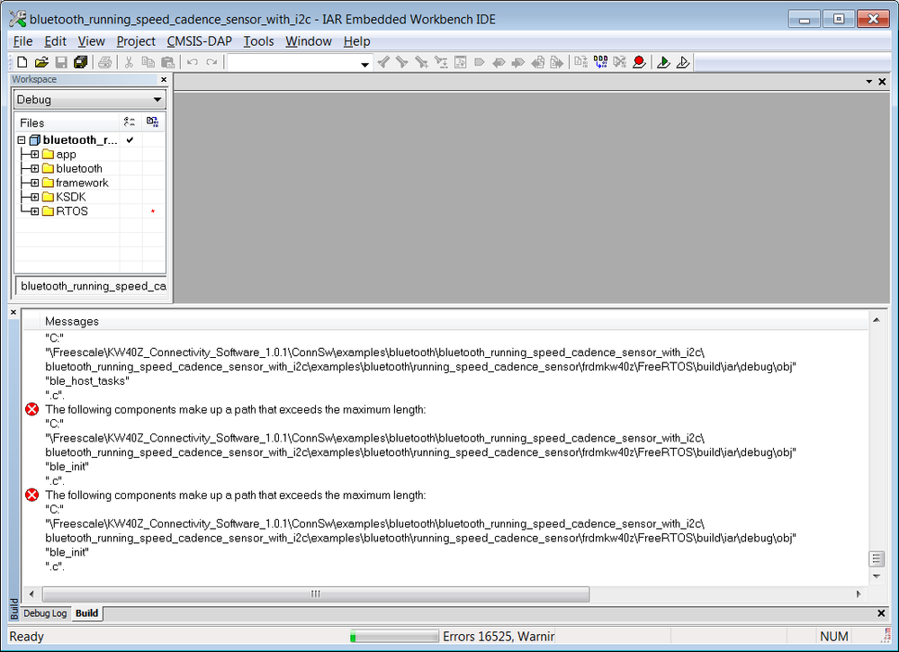

Hello, Tried running the above zip file per the instructions in the readme.txt file. I unzipped the project into C:\Freescale\KW40Z_Connectivity_Software_1.0.1\ConnSw\examples\bluetooth. Clicked on the workspace
C:\Freescale\KW40Z_Connectivity_Software_1.0.1\ConnSw\examples\bluetooth\bluetooth_running_speed_cadence_sensor_with_i2c\bluetooth_running_speed_cadence_sensor_with_i2c\bluetooth_running_speed_cadence_sensor_with_i2c.eww
I did a clean and a build and got several errors that the paths were too long. I know the readme.txt files says to ignore the
long path errors but it never completed the build after a few hours. So I gave up. Any idea what I might have done wrong? Thanks! Mark
If there are directories in the Path that do not exist GCC can take forever to build something.
It is also wise to avoid any paths with with spaces when possible.  Don't locate projects in such paths.
Hi Mark,
I don't think it is anything that you have done wrong necessarily.  I did see this in testing but it didn't hold me up and I could never really find the solution, so I felt I had to get something out there knowing that this might come back up.  I think this error is due to some kind of compatibility issue between the version of IAR that the project was created in and the version you are using.  So I think there are two options:
