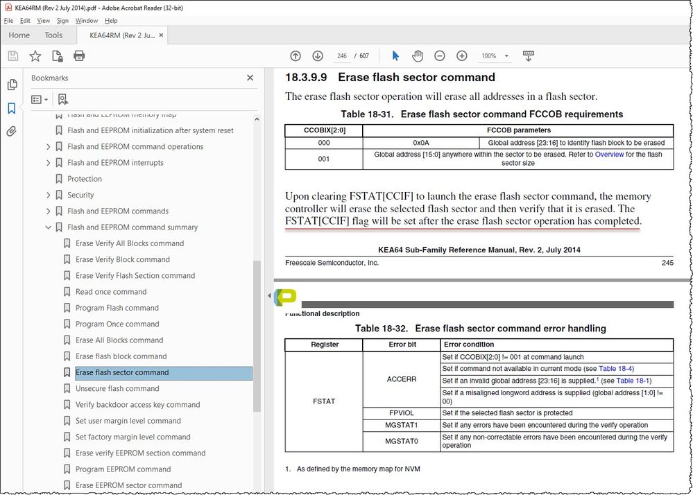

I am using S9KEAZN64AMLC mcu (Custom Board).
Is there any status bit in FLASH to indicate that flash is in process (Erase and write)?  like the FLASH BUSY status bit ?
How do we know that FLASH is completed erase or write?
1,606 Views
Robin_Shen
Please read the 18.3.9.9 Erase flash sector command of KEA64RM.
18.3.9.9 Erase flash sector command.jpg18.3.9.9 Erase flash sector command.jpg
