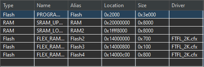

I am using the MK10DX256.  I am trying to move my application to address 0x2000 so that the bootloader will reside in 0x0000 - 0x1FFF.
When I attempt to debug my application it immediately faults.
Here is my memory setup:
In my main() I set SCB->VTOR = to 0x2000.  It does not appear my code is ever reaching the main() function.
If I move my application back to address 0x0000 I have no issues and it runs normally.  Any assistance would be greatly appreciated.

Hi pbaierlac,
Please refer to the discussion in How to debug bootloader and application codes together in MCUXpresso
Hope it helps.
Robin

pbaierlac
Thank for the help!  This did correct my issue.  It would be nice to just debug the application regardless of location like we could in code warrior.
