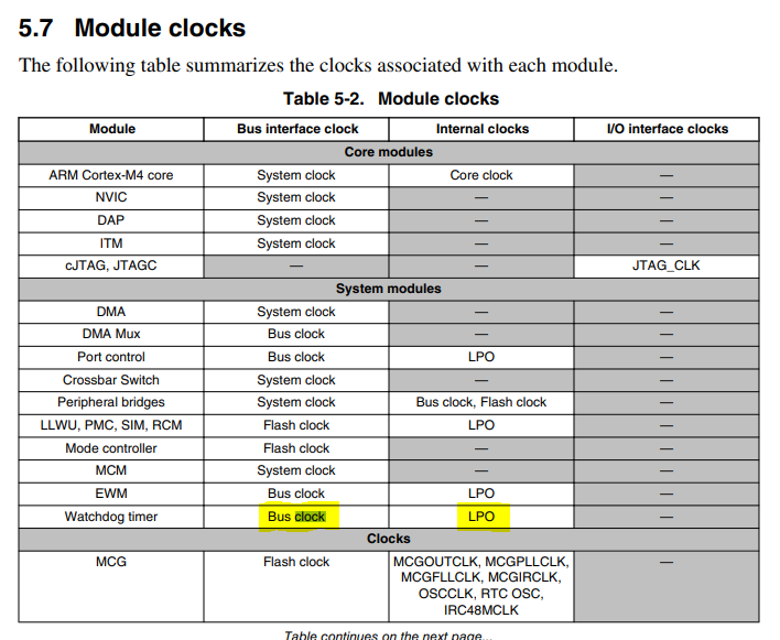

Please can you help me to find solution about my 2 questions.
I work on K22FN512
On KDS3.2.0 and MCUXpresso V11.01

What Clock is this "alternate clock source" ? this desciption is not accurate to be used.

1) What Clock is this "alternate clock source" ? this desciption is not accurate to be used.
The alternate clock source information will be found in chapter 5. The table in section 5.7 of the reference manual describes the two options for the watchdog timer: Bus Clock or LPO.
pastedImage_1.png2) The examples for MCUXpresso are slightly different from how the configurations were in KDS. In MCUXpresso the drivers for watchdog are fsl_wdog.c/.h. Here you can find the APIs for the configuration and usage of the same. Can you please elaborate what it is you are looking for as to the watchdog drivers?
