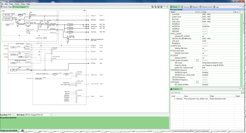

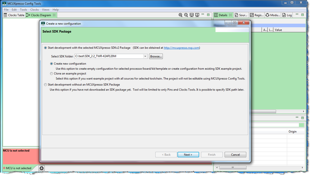

If the outside circuit of System oscillator is different from TWR-K24F120M, you can create new configuration based on SDK by using MCUXpresso Config Tools.
