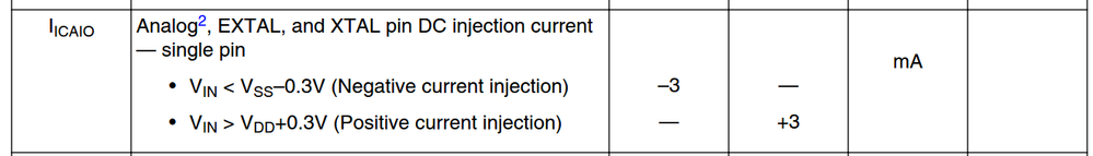

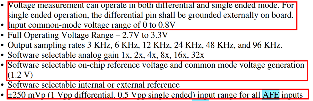

I'm using KM34Z256VLL7 in my design, the datasheet describe as follow, and I have some questions to check:
1. Is the full operating voltage range 2.7V~3.3V or -2.7V~3.3V.
2. I know the AFE inputs is 1Vpp differential and 0.5Vpp single ended ,if over the range the ADC result will be saturated, but I can't find the maxium and minimum input range about the AFE pins, if my input voltage is -2V~3.3V,will the AFE module be damaged.

2)here are external signals input to SDADMx and SDADPx pins for sampling, the protection is necessary.
My question is what is the absolute negative voltage of these pins? Are the acceptable input voltage range -2.7V~3.3V?
>>>>>>Generally, there is internal diode which protect the ADC converter if the ananlog pin voltage exceeds the rating range, but the current should be less than 3mA.
If you input -2.7V for the ananlog pin with 1K serial resistor, I think it is okay, the chip can not be damaged.

Hi, Jeff,
 I think the RM of KM family is confused, I will clarify it. Note that the SDADC only supports differential mode, the common voltage is from 0~0.8V, the P to P voltage is +/-0.5V in differential mode.
It is regarded as single ended mode if you connect the ADADMx to GND, but in the case, you have to use the differential mode regulation. The peak to peak voltage is +/-0.5V, the common voltage is from 0V to 0.8V. Because the P-P voltage is 0.5V, and SDADMx pin is clamped to GND, you can input 0V to 0.5V to SDADPx pin considering the common voltage is 0~0.8V. If the SDADPx pin is 0.25V, the SDADMx pin can be -0.25V.
the LSB is 1V/2**(24) so that you can calculate the volatge based on digital sample.

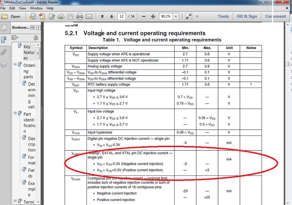

There are external signals input to SDADMx and SDADPx pins for sampling, the protection is necessary.
My question is what is the absolute negative voltage of these pins? Are the acceptable input voltage range -2.7V~3.3V? (of course i know the valid samping voltage is +/-250mV).
Another question is about the CM reference voltage 0~0.8V, if the SDADMx pin is clamped to 0.5V, what is the input range of SDADPx pin? --> 0.5V~1.3V? OR 0.5V~0.8V? OR 0.3~0.8V?
