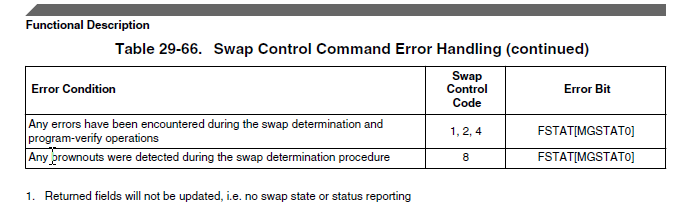

I get this error, sometimes I cannot recover without going back and programming with the JTAG debugger.  Does anyone know what causes it and what it actually checks to determine the error?  The reference manual has this:
Any errors have been encountered during the swap determination and
program-verify operations
But it's not enough information to tell me what is causing the error.  Are there registers that I can check to see what is going on?

This return value is a result from calling FlashCommandSequence(), when bit0 of FTFL_FSTAT is set. Please kindly refer to the following for details.
I am not sure where you put the swap indicators, actually if the sectors containing swap indicators get erased in UPDATE or UPDATE-ERASED state, by some process to update the firmware or something like that, the swap system would report issue.
Hope that helps,
Kan
