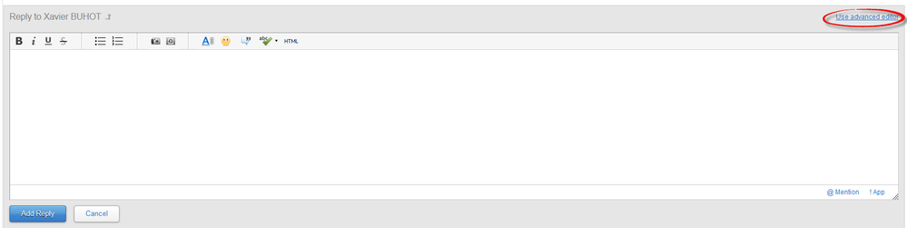

Xavier BUHOT,
just make a .zip and upload here by this way:
Iva
