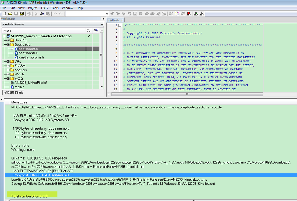

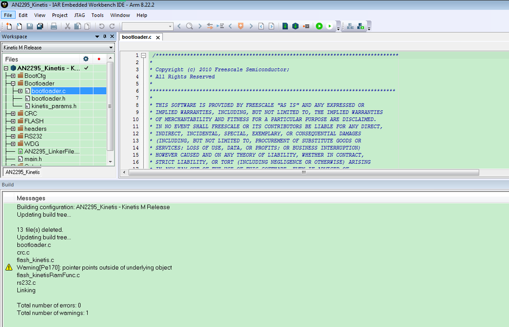

Hi DHRUV A,
   I have use the IAR 7.80 to open it, it builds without errors.
I also tried the IAR 8.22 version, also no problem
So, you need to update your IAR version.
Wish it helps you!
Kerry

dhruvonline
Hi Kerry,
Thanks for the support.
I have tried with IAR 8.21. Now we are able to open the project.
