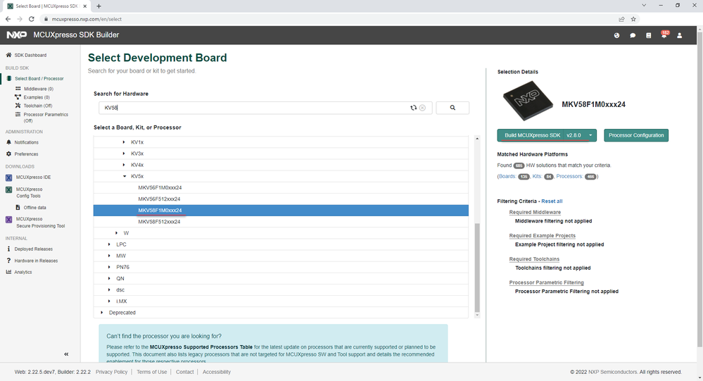

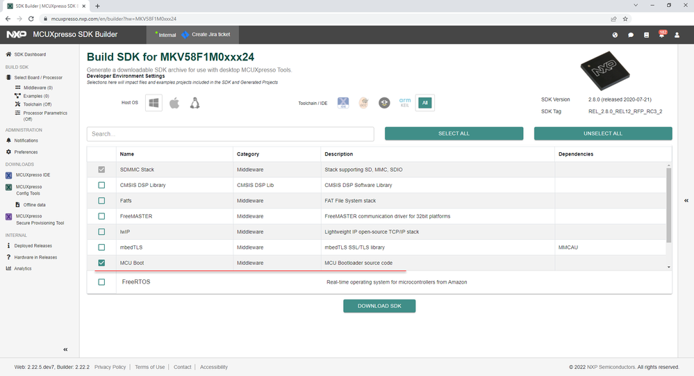

MCU-Boot is recommend for new design, you can get it from https://mcuxpresso.nxp.com/en/select
bootloader_examples can be found in the latest SDK_2_8_0_MKV58F1M0xxx24.

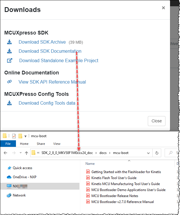

Documentations about MCU-Boot can be found here:
