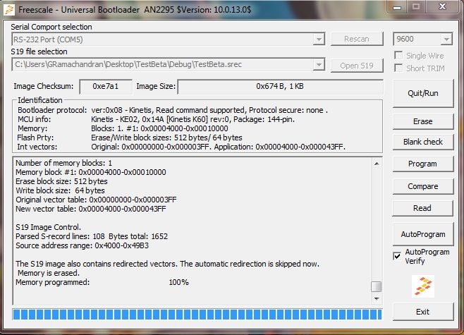

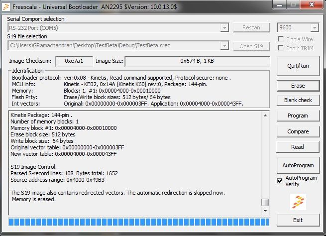

Hi I am using MKE02Z64VLD2 microcontroller in KDS 2.0 IDE.. For me memory is getting Erased and Programmed perfectly.
My application code name is TestBeta which is a simple code to blink LED. I converted this Application file into S19 file and I included it under s19 file section.
Memory is Erased
Memory is programmed
But the LED is not blinking.
What is the problem ?
OR
I have to do something else to run the application file ?

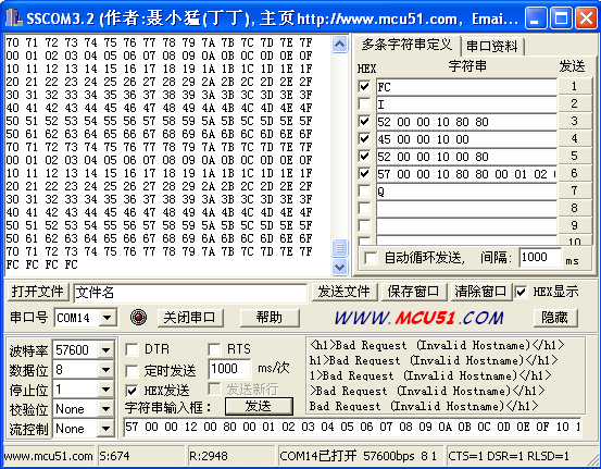

Good news: AN2295 works for downloading now,
Bad news: It only works under terminal window, we need update client software.
I have no other solution, so I have to use my barehand tool, SSCOM32 to emulate traffic between bootloader and win_hc8sprg. The following traffic is good.
PC->MCUMCU->PC
FC FC FC FC (keep sending out FC, cause warning locking 0xFC on win_hc8sprg.
FCFC (ACK)
'I'88 14 86 00 00 00 01 00 00 10 00 00 00 FF FF 00 00 10 00 00 00 00 00 00 00 04 00 00 00 00 80 4B 4C 32 00 00 (Identification)
45 00 00 10 00FC (ACK, erasing done)
57 00 00 10 80 80 00 01 02 03 04 05 06 07 08 09 0A 0B 0C 0D 0E 0F 10 11 12 13 14 15 16 17 18 19 1A 1B 1C 1D 1E 1F 20 21 22 23 24 25 26 27 28 29 2A 2B 2C 2D 2E 2F 30 31 32 33 34 35 36 37 38 39 3A 3B 3C 3D 3E 3F 40 41 42 43 44 45 46 47 48 49 4A 4B 4C 4D 4E 4F 50 51 52 53 54 55 56 57 58 59 5A 5B 5C 5D 5E 5F 50 61 62 63 64 65 66 67 68 69 6A 6B 6C 6D 6E 6F 70 71 72 73 74 75 76 77 78 79 7A 7B 7C 7D 7E 7FFC (ACK, programming done)
52 00 00 10 80 80
(Readout content, good)
'Q'(No response), drops into sending FC on and on...
FC FC FC
Interesting! It works on AN2295 + SSCOM32.
Maybe we can draw a conclusion. The win_hc08sprog has not updated to support Kinetis? Well that is a problem, who can solve that? That's a part of bootloader package.
For debug and test purpose, I can write a Python script w/ SREC parser to download custom firmware dedicated for KL25Z. But a stable general purpose bootloader software takes more time.
Even the PC client software is done, we need more time to validate the demo application with icf file.

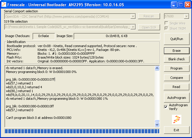

Hello, Ma Hui.
Thanks for your update software. My previous one is v10.0.12.0. Now I got a version promotion to v10.0.16.0. I have no idea why its size grows from 1.8MB to 6.1MB.
You can see, the programming still fails. The highlight is that it reveals everything on console. So we can find following information.
prg_blk: 0x00001080-0x000010ff
wb(57,) returned 0 (programming success of last block returns as 1)
Can't program block 0 at address 0x00001080
I checked the return value, which is a byte count of being sent out. No a response from bootloader. That means something wrong in software which can not send out on serial communication.
The software is making progress, we are very close to success. That's really good.
Anyway, we still need to remove the bug.
I am working on a simple Python script as plan B, no sure when I can finish it.
