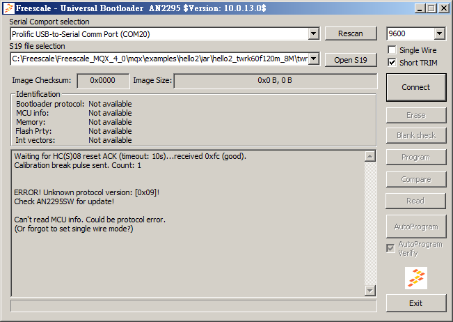

Dear All
My compiler tool is IAR.
K60_120M
I got error message as below:
Why?
Thanks!

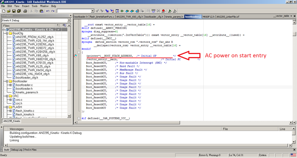

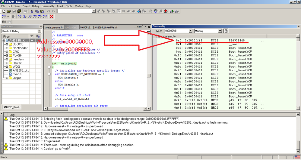

楊智翔楊
The problem has been resolved,to upgrade "win_hc08sprg.exe" version to 10.0.18.0.
However,I got another issue done the AN2295 procedure(User code on 0x00004400).
Can't boot up after AC power.I founded the reset pin always high and low.What happened?
Thanks!
B&R.
2,632 Views
楊智翔楊
AN2295_LinkerFile.icf
/*-Memory Regions-*/
define symbol __ICFEDIT_region_ROM_start__      = 0x00000000;
define symbol __ICFEDIT_region_ROM_end__        = 0x00003FFF; // 0x000004FF for 8K Flash devices
define symbol __ICFEDIT_region_RAM_start__      = 0x1fff0000;
define symbol __ICFEDIT_region_RAM_end__        = 0x1fffffff;
define symbol __ICFEDIT_region_RAM1_start__     = 0x20000000;
define symbol __ICFEDIT_region_RAM1_end__       = 0x2000ffff;
define symbol IntVectTable_start__              = 0x00000000;
define symbol IntVectTable_end__                = 0x0000003f;
define symbol FlashConfig_start__               = 0x00000400;
define symbol FlashConfig_end__                 = 0x0000040f;
define exported symbol __BOOT_STACK_ADDRESS = __ICFEDIT_region_RAM1_end__ - 7;              //>>>>>>>>  ?????? Is correct?
bootloader.c
Ahter Running......
Can't boot up after AC power. Is the entry point uncorrected?
