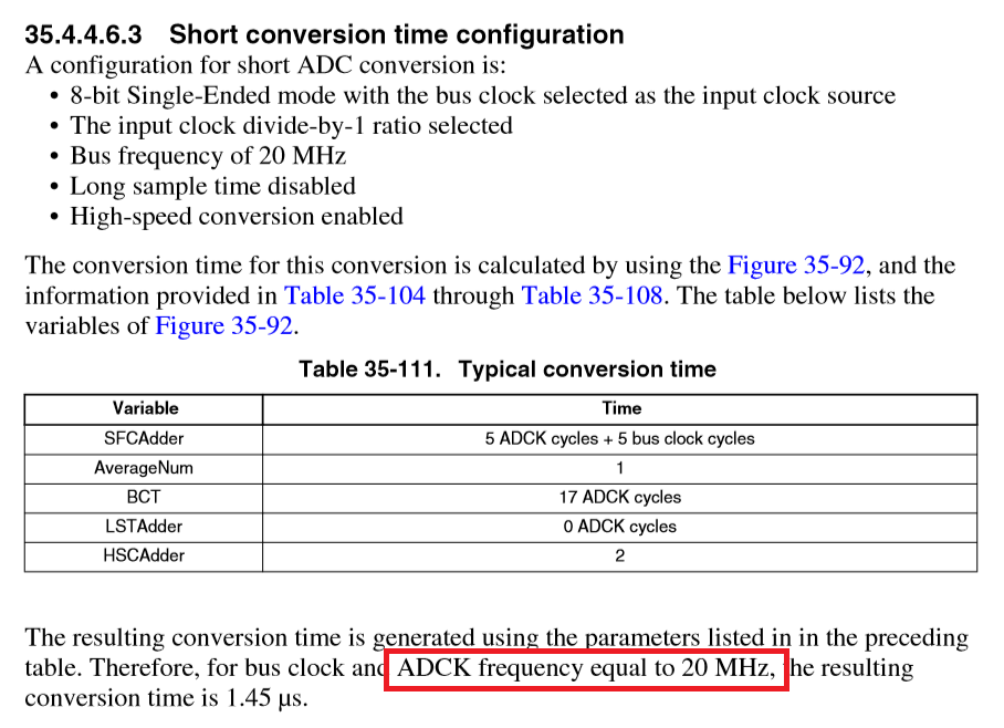

Yes Kerry, would you please do the calculation for me. I am in the same situation. I don't get it. What you did not include in the tables above, is the fact, that the K64 has an ADC clock limit of 18 MHz (and 12 MHz in 16 bit mode). Now, will you please prove to me (and everybody else), how 16 bit resolution is reachable at 461 ksps?
I think NXP tries to hide the true convertion rates, and that the rates given in the datasheet is only for 8 bit resolution. Please prove that I am wrong. You will break my heart, if you say that the convertion rate is limited to 12 MHz / (34+5+5) clks = 272 ksps for 16 bit resolution and 18 MHz / (30+5+5) = 450 ksps in 13 bit resolution (differential). Here assuming the bus clock equals the adc clock - it does not really matter that much.

And let me also add this. In the reference manual for K24 is an example where the ADC clock becomes 20 MHz, but which Kinetis chips can run at 20 MHz?
