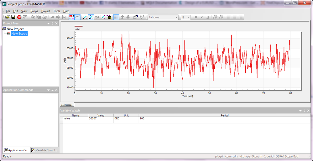

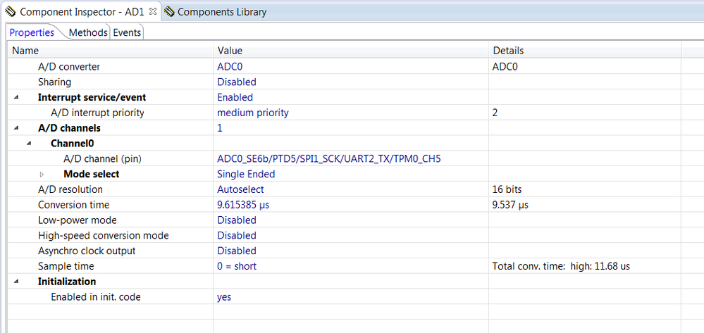

I configured the ADC for the FRDM KL25Z board as in:
This is my code:
  (void)AD1_Calibrate(TRUE);
  for(;;) {
    (void)AD1_Measure(TRUE); /* do conversion and wait for the result */
    (void)AD1_GetValue16(&value); /* get the result into value variable */
The readings are (with the PTD5 pin connected to 3.3v):
any idea?

Hi Matt,
1) From  the waveform , it seems that it haven't input signal in ADC0_SE6b pin, I suggest you check the pin  use  scope;
2) I suggest that before read the result , measure the complete status ,  the detail code you can refer to the "help on component ";
3) You can change anther pin to try .
Hope it helps
Alice
