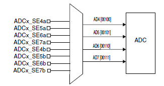

But when I want to get the measurment form the sensor connected to PTE21( ADC0_SE4a ) I get MeasuredValue[0] = 0 despite touching it. But if I touch the PTE20 sensor instead of PTE21 it measures the value for the PTE20 sensor. So if I measure them both at once (one after the other in the code) and press PTE20 i get FsrReadings[PTE20]=FsrReadings[PTE21]. If I touch PTE21 it looks as if I hadn't touched any sensors FsrReadings[PTE20]=FsrReadings[PTE21]=0. It's the same for the pair PTE22 / PTE23 ( PTE23 doesn't work ).
Do you know what may have caused this? Might it have anything to do with the 'a' letter at the end of ADC channel name ( ADC0_SE4a, ADC0_SE7a )?

I was informed that there is a Processor Expert problem when an code is incorrectly generated so the pins are selected incorrectly (exchanged). The problem has been already fixed and the fix will be available in the final version of CW10.3, that should be available next week.
Unfortunately, there is additionally a limitation that the AD1_SelectSampleGroup method of the ADC_LDD component cannot handle the MUX switching between "a" and "b" pins (e.g. you are using ADC0_SE4a and ADC0_SE4b).
At the moment, it needs to be resolved (as already suggested in previous post) by using only one type of pins (a or b  for all channels) or you would have to add your own code handling the pin and channel selection. We are planning to improve this in the next version.

adriansc
Maybe this information will help you. An analog pin with b or a suffix are different, are not the same external pin, but both are the same ADC channel, you can see this in the next figure (Kinetis Microcontroller K60 RM Figure 3-32. ADCx_SEn channels a and b selection ):
As Earl Goodrich II said, the MUXSEL value is defined in ADCx_CFG2.
I recommend to use only one pin for each channel (a or b). Instead of changing MUXSEL value each time you read ADCx_SExa or ADCx_SExb.
Some pins are ADC default, if you are using one of them for another module you will need to change MUX value in PCR register.
Hope this helps.

I don't know anything about the particular driver you are using (ADC_LDD), but certainly the 'a' vs. 'b' suffix on SE channels directly defines the required value of MUXSEL in ADCx_CFG2.  Don't ASK me why the ADC has two signal multiplexer controls...
