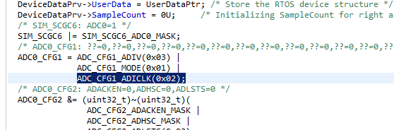

I'm learning about the ADC. And I'm using processor expert to learn about the different selections.

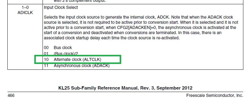

I see that it selects ALTCLK as clock input to the ADC module. But where does ALTCLK come from. I can't find it in the manuals.

The ALTCLK on KL25 is the OSCERCLK.  I will submit a ticket to get that information updated in the reference manual.

For the K10 i am using i find that information in the reference manual, chapter "Chip configuration". There i can find a aparagraph "Alternate clock".
