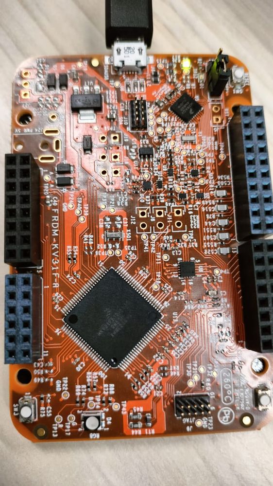

In mkv31f512vll12 controller how to configure ADC inject trigger with PWM Ontime  duty triggered how to configure?WhatsApp Image 2023-12-23 at 4.02.17 PM.jpeg
14,280 Views
xiangjun_rong
I have tested on my TWR-KV31 board, I can enter ADC ISR multiple times, so it is okay.

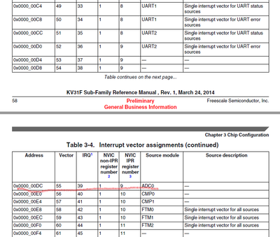

void FTM0_IRQHandler(void)
if (FTM0->STATUS & FTM_STATUS_CH0F_MASK)
FTM0->STATUS &= ~FTM_STATUS_CH0F_MASK; // Clear the channel flag
//ADC0->SC1[0] = ADC_SC1_AIEN_MASK | ADC_SC1_ADCH(8); // Start ADC conversion on channel 8

void ADC0_IRQHandler(void)
if (ADC0->SC1[0] & ADC_SC1_COCO_MASK)
// ADC0->SC1[0] = ADC_SC1_AIEN_MASK | ADC_SC1_ADCH(8);
GPIOC->PTOR = 0x40; // Toggle indicator
sample[0] = ADC0->R[0];

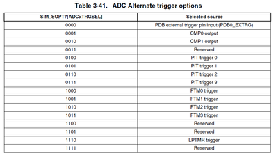

If you want to use hardware triggering mode, you have to configure:
1)set the ADCx_SC2[ADTRG] bit, it means that the ADC will be triggered by the hardware instead of software
2)configure the SIM_SOPT7 register, it defines the triggering source of ADC. For detailed inf, pls refer to section 3.7.1.7 ADC triggers in the RM of KV31
For example, if you select PIT trigger 0, you have to configure the PIT channel0 so that PIT channel0 can generate triggering signal, while configure SIM_SOPT7[ADCxTRGSEL]=4;
Hope it can help you
XiangJun Rong

Pls refer to the attached an5142.pdf, in the section 3.7. FTM triggering ADC, the FTM triggering ADC is discussed and the code is given.
But You use both the FTM diver and ADC driver instead of writing register.
anyway, you have to write the following registers:
2)configure the SIM_SOPT7 register to select the triggering source
3)write the FTM0_EXTTRIG to select which CVx register can generate the triggering signal.
I suppose that you can use the code directly.

xiangjun_rong
For KV31, the ADC1 interrupt vector is 73.
NVIC->ISER[2] |= (1 << 9); //setting interrupt of ADC1
//NVIC->ICPR[2] |= (1 << 9); //clear interrupt  pending bit
Pls check if you can enter ADC1 ISR.
XiangJun Rong

xiangjun_rong
1)As I attached the ADC triggering source, the FTM0 index is 4b'1000 or 8, so you have to use the line:
SIM->SOPT7 = SIM_SOPT7_ADC0TRGSEL(0x08) | SIM_SOPT7_ADC0ALTTRGEN_MASK; // FTM0 trigger ADC0
2)For the ADC0 interrupt vector is 39, so you have to write the line:
NVIC->ISER[1] |= (1 << 7); //39-32=7
3)The FTM0 triggers ADC0 and the ADC0 generates interrupt after conversion is over, so it is unnecessary to have FTM generate interrupt. pls comment the line:
//FTM0->SC |= FTM_SC_TOIE_MASK;
4)I suppose that you know the mechanism of the FTM0 triggering ADC0, if you set the line:
FTM0->EXTTRIG |= FTM_EXTTRIG_CH5TRIG_MASK;
when the FTM0 counter reaches up to the value of FTM0_C5V, the FTM0 triggering event will happen, because the SIM->SOPT7 = SIM_SOPT7_ADC0TRGSEL(0x08); the FTM0 triggering event will route to ADC0, because the ADC0 is configured as hardware triggering, the analog channel in ADC0_SC1[0] will be converted with FTM0 triggering event.
So you have to initialize the FTM0_C5V and the ADC0_SC1[0]
I suggest you use the original code in the AN, because the code is based on K40, you use KV31, so you have to change the code to adapt to KV31.
XiangJun Rong

ADC0->CFG1 = ADC_CFG1_ADIV(4) | ADC_CFG1_MODE(1) | ADC_CFG1_ADICLK(0); // ADC clock is bus clock/2, bus clock is 20M, ADC clock is 10MHz
ADC0->CFG2 = 0x00;
ADC0->SC2 = ADC_SC2_ADTRG(1); // hardware triggered
ADC0->SC2|= ADC_SC2_ADACT(1);//conversion start
ADC0->SC3 = 0x00;
SIM->SOPT7 = SIM_SOPT7_ADC0TRGSEL(0x08)| SIM_SOPT7_ADC0ALTTRGEN_MASK;
