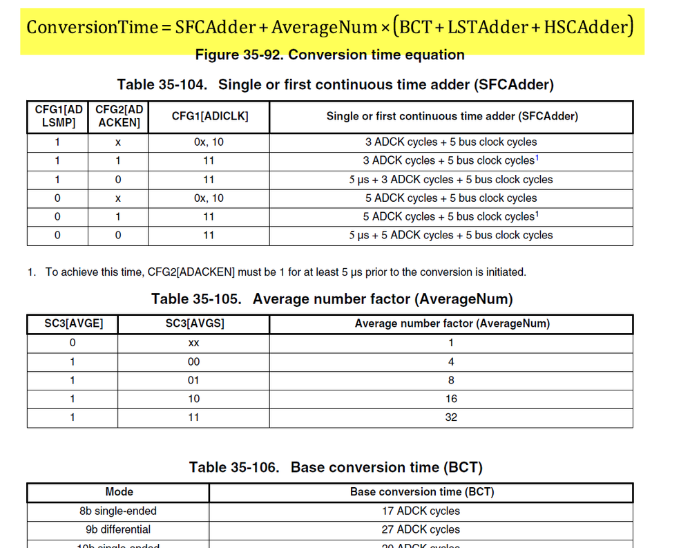

    Actually, the ADC conversion time can be calculated, it is totally determined by your ADC module configuration.
   Please check the K24 reference manual, chapter: 35.4.4.5 Sample time and total conversion time
Please calculate the conversion time with your ADC configuration, then you can determine what the FTM trigger time you need to use.
You also can use the continuous mode to test the conversion time at first.
Please calculate it at first.

Thanks for the timely reply. I have already calculated the ADC conversion time and it is 6,1041 µs. My Timer triggers every 10µs. I could reduce my ADC conversion time to 5,101 µs by removing the Long sample time of 10. At the Moment, both my ADCs ( I assume I have two ADCs as stated in K24 reference Manual ) run at 6 MHz with 16-bit Resolution and my System Clock Frequency is 48 MHz. All this works good. But, as soon as I enable the Hardware averaging with 32 conversions, I expect to get an ADC Interrupt or Setting of COCO flag after 32 * 10µs = 320 µs.
But when I measure the Interrupt Interval, I measure every time around 165-170µs.

I have recalculated my ADC conversion time for 32 Hardware averaging counts and it is Correct what I measure. It is 165.93 µs.
That works good. The Continuous mode seems to also work on both the ADCs parallely.

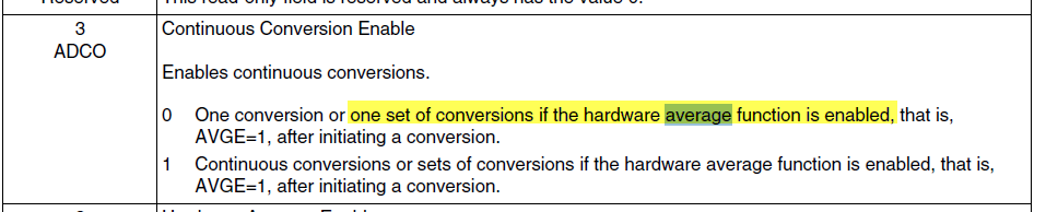

Thanks to you too for your Support. Actually, the Problem is not completely cleared. My Goal was to sample both the ADCs with a single Hardware Timer as Trigger Input and compute 32 consecutive such measurements ( which with the corrected ADC conversion time of 5.77µs for one measurement should be at 32 * 5.77µs = 184,64µs ) and take an average for the 32 measurements. So, instead of me doing all the measurements and taking an average, I found the Hardware Averaging Feature quite apt for my requirement. But, as I stated before I always get my Interrupt only after170µs which makes me understand that Hardware Trigger and Hardware averaging are not to be used together??
This makes me understand that the Hardware averaging Feature is meant only for Continuous conversions and it does not depend on the Timer Trigger Input.
I am really interested to know what exactly is actually meant with Hardware Averaging Count ?? and whether it is Independent of Hardware Trigger?

    Hardware conversion is not only in continuous mode, please check these information:
So, actually, you totally can use the hardware trigger, if you trigger one time, and you enable the hardware average function, then one set of conversion will be converted.
But please note, you must make sure your hardware trigger intervals larger than the hardware average conversion time.
Wish it helps you!
