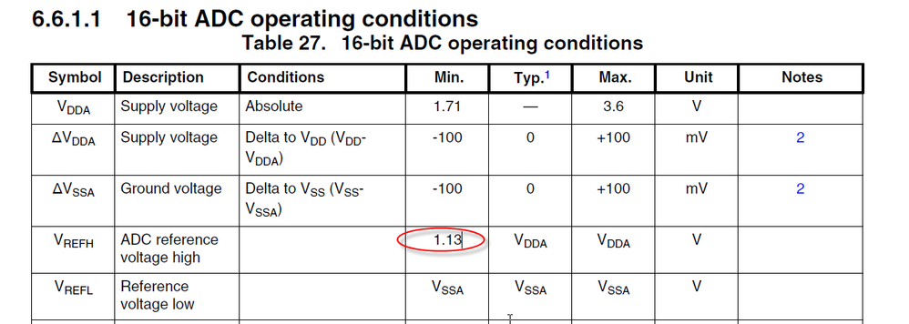

      I try to interface the temperature sensor with k53n512 and I need to know the reference voltage options to use for ADC.Please tell me that bandgap reference voltage can be used as ADC reference voltage.I tried with internal regulator voltage 1.75 and MCU AFE reference as 3V.But i need to to use 1.4 to 1.5V.Could anyone make a clarification for exact usage and various ways of reference voltage for Single ended ADC.I am using single ended ADC.Thanks in advance.

Per the data sheet, you may directly apply 1.4 to 1.5v on VREFH, please kindly refer to the following for details.

If you don't end up using the bandgap as a direct ADC reference, if you are willing to do two conversions you can use it as an indirect reference, as spelled out in AN3031 or my post:
On-chip temperature Calculations
As noted in there, the bandgap stability is, however, 'not great', with an 80mV drift band (Vtdrift) across temp, which is > +/-3%.
