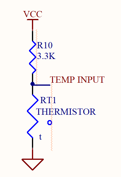

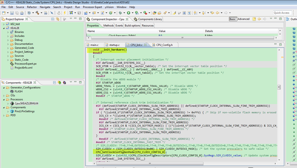

Came across an interesting issue and currently not satisfied with the "fix" performed. Some background, during testing of the MKEAZ128 chip a custom control board an issue was found that seemed to be an issue with the thermistor placed on A6 (which I recognize is defaulted to ADC). Once the Thermistor reached ~90 F the processor started to get hung up and wouldn't connect to the controller. Soon we found out the processor would work with no issues at those temperatures if it was on before turning it up that high. After further investigation SystemInit() was getting hung up at the following spot.
What is in red is where the code would get hung up. However, When adding the code in blue (pin A0) everything would work fine and the proper clock would be selected. Any hints on why this is a problem? For now we are continuing testing and this weird code works. (The A0 pin is tied to a 10k resistor and goes out to a header.) However I still am not satisfied with not understanding this. Any hints, suggestions, or reasoning would be greatly appreciated! Thank you!

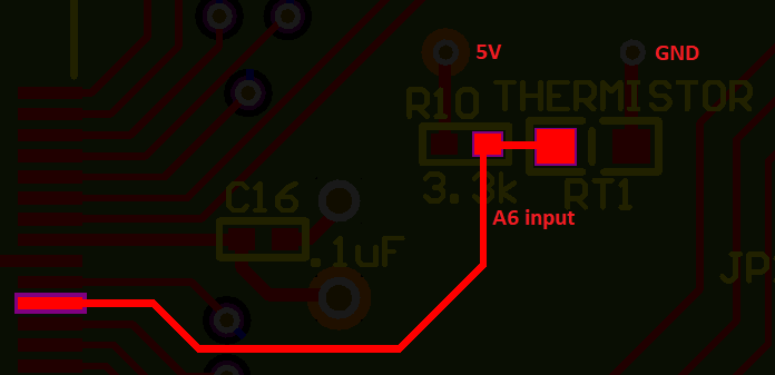

codyhubman
It is a similar problem to my KEA128 64 pin, 44 pin ke06z128, and 64 pin ke06z128. Because It doesn't seem to be an issues with the FRDM board I am suspicious that it is a hardware problem... It's a really weird problem
11,520 Views
kerryzhou
Hi cody hubman,
   A test thought for your own board, but you need to do it very carefully.
  Find a tweezer, just move the PTA6 pin leave your own PCB, then heat the pin again, whether you still have problems or not?
  It seems your hardware is influenced by your thermistor, maybe some interference flow to the power, the crystal, or the ground signals.

codyhubman
That's a really good idea I'll give it a shot. However, on my 44 pin board I had the same thermistor circuit but setup with a through hole that protruded at least an inch from the board. But I will still give it a go
11,546 Views
codyhubman
So I disconnected the PA6 pin and the code startup up as normal after heating up the thermistor so at least it's not a layout issue. Is there something in the internal circuitry that would cause issues with this circuit pastedImage_1.png

kerryzhou
Hi cody hubman,
      The code which I give you is based on the PE KDS.
      About the clock code, please check the following __init_hardware API:
  Of course, you also can choose the FEE mode by referring your own external crystal.
Kerry

codyhubman
So this is in the MKE06Z.C startup code file and it's part of a prebuilt setup in Kinetis Design Studio. I assume this is NXP official code. Clock Setup 0 or 1 suggests it starts with FEI. But It gets stuck on a similar while loop. (I think). I'm also not sure if there is an interrupt causing an issue but idk why that would be the case.
Im so thrown off why my thermistor would be affecting my ICS selection. It works perfectly fine if I activate any random ADC Default GPIO before it checks to see which clock has been selected. I'm not at work now otherwise I would have posted the rest.

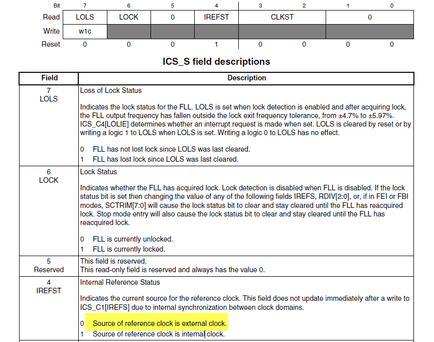

kerryzhou
Hi cody hubman,
   When you meet the code is stopping your red area:
From the RM register:
So, when you code stop there, it means your external OSC is stopping oscillating, you can check your hardware, check the osc pin, whether it is oscillating or not.
 BTW, you also can try to use the internal IRC, whether you still have this problems or not?
