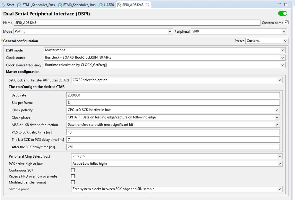

I'm using a k02FN64VLH10.
I want use the SPI to transfer 4 bytes to a analog converter. The ChipSelect signal must not be unasserted between theses 4 bytes.
Then in McuXpresso SDK configuration for the Spi peripheral, I configured like this:
Then the DSPI_MasterSetDelayTimes is called from DSPI_MasterInit with following parameters:
Base : SPI0
WhichCTAR = CTAR0
whichDelay = kDSPI_BetweenTransfer
srcClock_Hz = 49999360
delayTimeInNanoSec = 250.
Then At the end of this function, the function DSPI_MasterSetDelayScaler is called with:
prescaler = 3 (= Div/7)
scaler = 0 !!...
Then I called the functin to start transfer like this:
 MasterXfer.txData      = Buffer;
  MasterXfer.rxData      = Buffer;
  MasterXfer.dataSize    = NumberRegsisterToRead + 2;
  MasterXfer.configFlags = kDSPI_MasterCtar0 | DV_ADS1248_SPI_PCS | kDSPI_MasterPcsContinuous;
  DSPI_MasterTransferBlocking(DV_ADS1248_SPI_CHANNEL, &MasterXfer);
But on the scope, I get 8 clock pulse, then the following 8 start immediately, there is a very small time (80ns) instead of the configured value (=250ns = 1 clock pulse)...
To resolve the problem, I must change the ConfigFlag by remove the kDSPI_MasterPcsContinuous. By this, I have good clock, but the Chip select signal is deaserted between each byte.
Then I rout the Chip Select pin to a normal GPIO I forced to 0. But I get a warning into the SDK because PCS0 is not routed...
How have a continous ChipSelect with a correct Tdt? I try to change DT to the max (16) and PDT to 3 to have the maximum time without success...

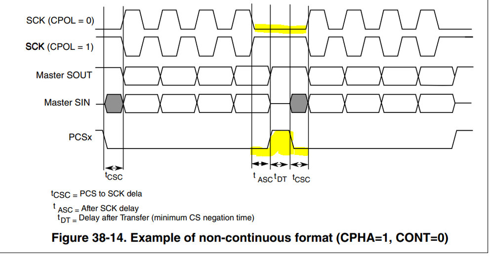

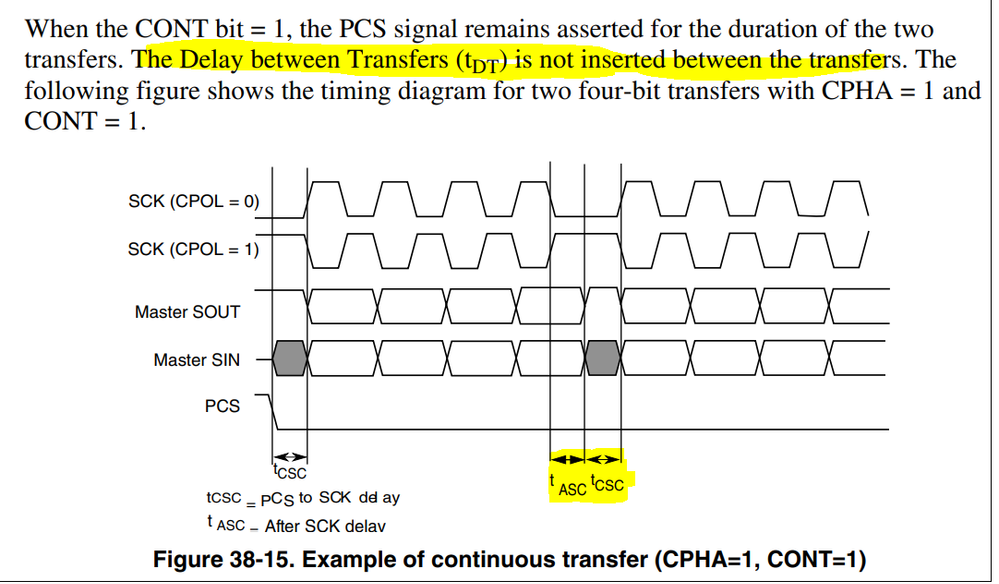

In this case, to achieve the desired time between byte transfers (250nS)   you will need to increase the
 PCS to SCK (tCSC) and SCK to PCS (TASC) delays.
Please note that when  PCSx is asserted during all the byte transfers, which is  continuous chip select flag enabled,
the time between each byte transfer won't be determined by Time Delay transfer equation (Tdt= 1/fp * PBD*DT),
 It will be the addition of PCS to SCK and SCK to PCS delays. Please refer to the following image.
 That could help to explain why after you set the DT and PBD prescalers, (of CTAR0 register) to their
 maximum values, to increase Tdt,  the time between transfer did not increase.
As you mentioned before, after disabling the continuous chip select you
get the desired  (Tdt),  but the chip select signal gets
de-asserted. As shown in the following image.
To get further information please refer to chapter 38.4.4.5 Continuous Selection Format of the device reference manual.

The problem was the time between each byte.
The PCS0 must be maitain betwwen each byte (with flag kDSPI_MasterPcsContinuous)
But with this, the field "After the SCK delay time" have no action.
In fact, it is the "PCS to SCK "and "Last SCK to PCS" which have both effect on the time between each byte. Like if the PCS signal was managed between each byte. Then I no found where the "After the SCK delay time" was effect...

Thank for your complete answer which explain my observations.
I read the datasheet, but not enought! I had not take enought attention to these chronogrames.
Thank
