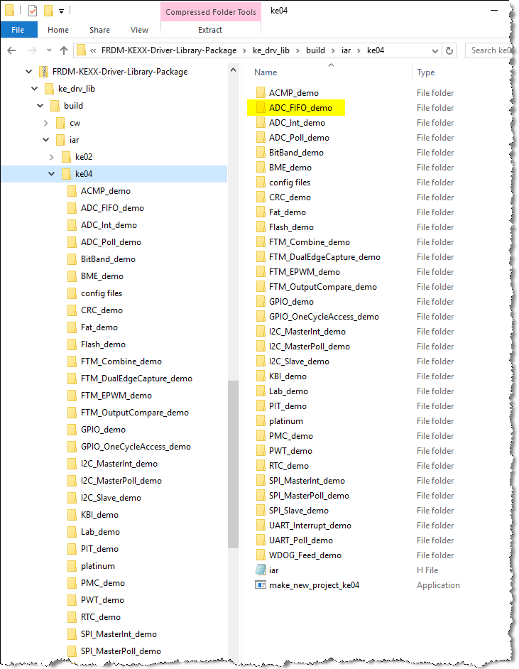

   I want to sample 8 channels of ADC with single command(SW or HW trigger) without any CPU intervention.
   Is it possible to use FIFO mode of ADC for this purpose as FIFO mode offloads CPU and gives an interrupt only after sampling of all the ADC channels in ADC channels FIFO has been completed.
Also, is there any sample code that can be used for FIFO operation in MKE04Z64VLH4.
Thanks and best regards,
Prasanna
1,557 Views
Robin_Shen
Hi Prasanna,
Please download the FRDM-KEXX Driver Library Package (REV 2.0).
Then you will find the ADC_FIFO_demo.
