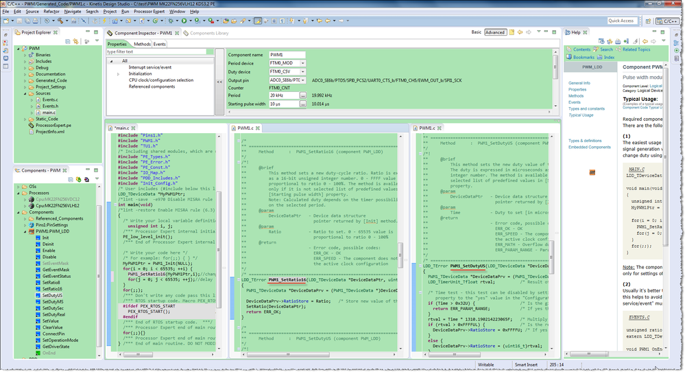

Hi, I have been adjusting my duty cycle manually in my code.  What I would like to do is is connect a potentiometer to PTB1/ADC0_SE9 and send the result to my variable DutyCycle.  I'm using Kinetis Design Studio 3.2.0.
Can someone direct me where there's a resource and/or help be get started?
Brian
1,092 Views
Robin_Shen
Hi Brian,
Please try to use these two function:  PWM1_SetRatio16 or PWM1_SetDutyUS
