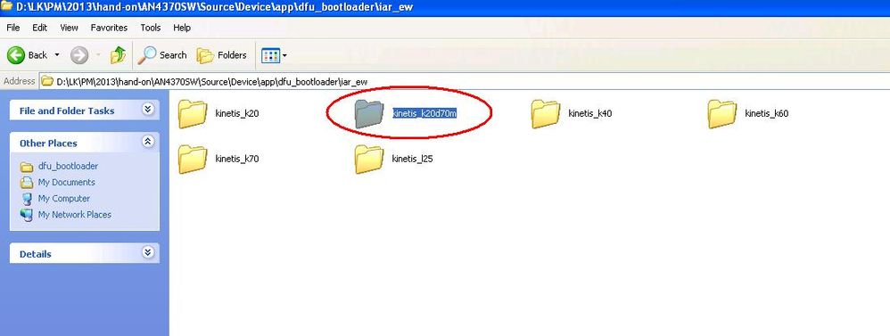

1.Copy the project file folder for K20D50M "AN4370SW\Source\Device\app\dfu_bootloader\iar_ew\kinetis_k20" and rename is as "kinetis_k20d70m"

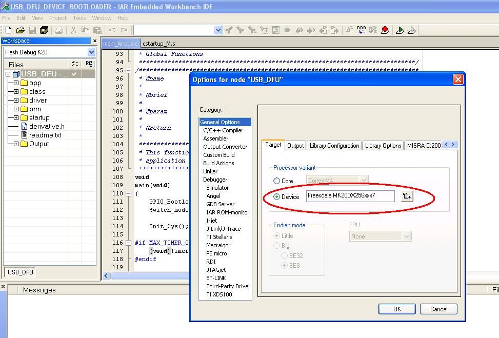

2.Change the target settings as well as the flash loader.

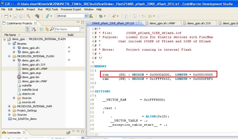

6. Copy the link file from K20D50M, and modify the PFLASH size,SRAM size and DFLASH size as shown below:

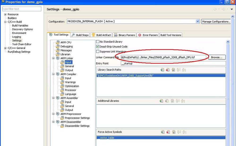

Actually the bareboard projects in KINETIS_72MHz_SRC can be used for that purpose, and only link file needs some modification to put the image starting from 0xA000, since exception table redirection has already been done in these projects.

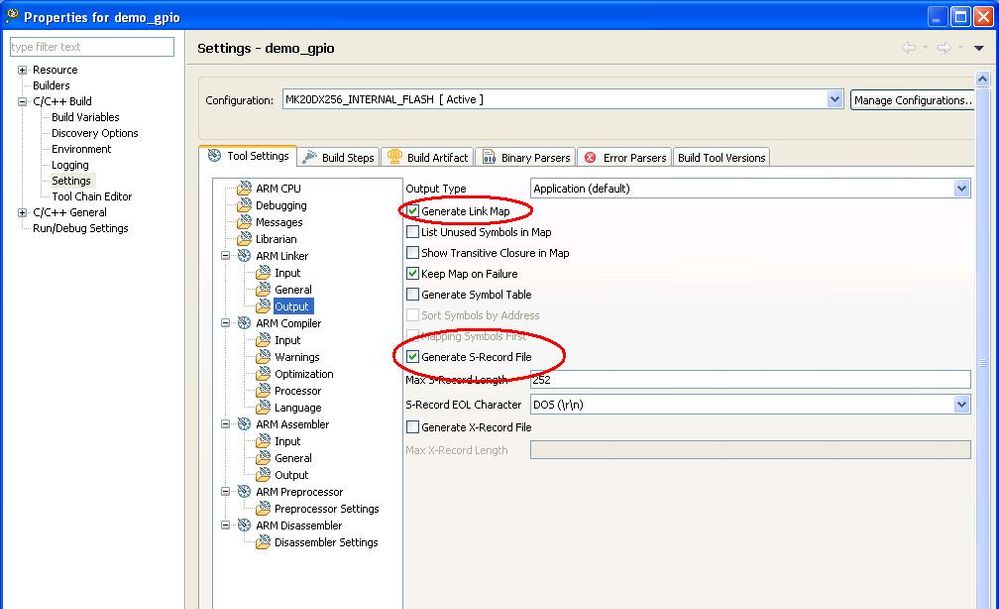

after that, user needs change some settings in the CW projects to use the new link file:
and generate S19 file as the output as well as the map file:

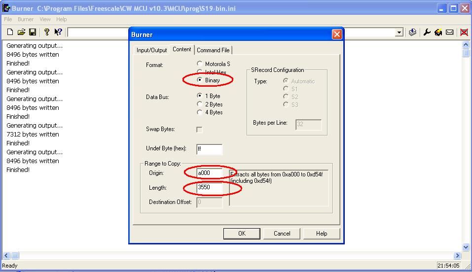

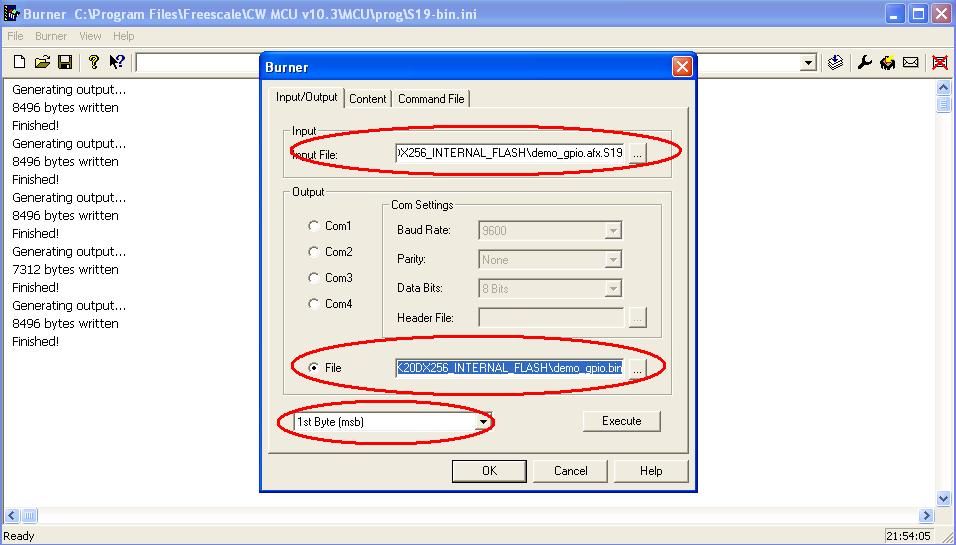

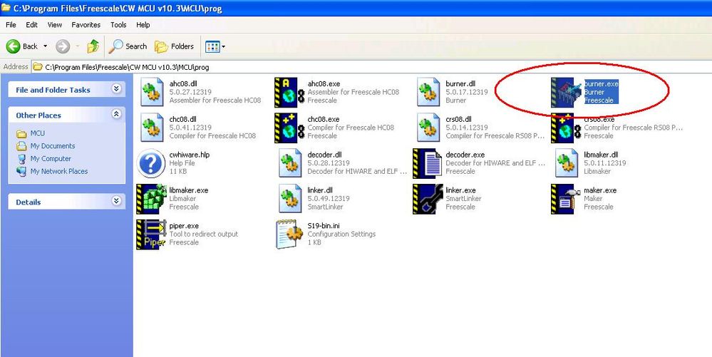

after compiling , you will have a xxx.afx.s19 file, but that is not the final format, we still need to transform it to bin format, and it can be done by a small tool in "C:\Program Files\Freescale\CW MCU v10.3\MCU\prog"
There are some settings for this tool to transform the S19 file, by clicking Burner->Burner Dialog, you will see some option views, please set them as below:

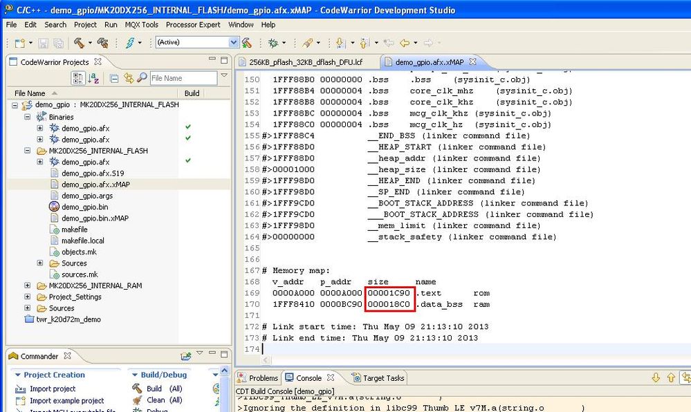

Referring to the above figure, maybe you would wonder how to set up the Origin and Length field, actually Origin is the value where the image starts from just as the link file specified , and Length is calculated by the results from the map file. Please refer to the following figure for details.
0x3550 = 0x1c90 + 0x18c0.
