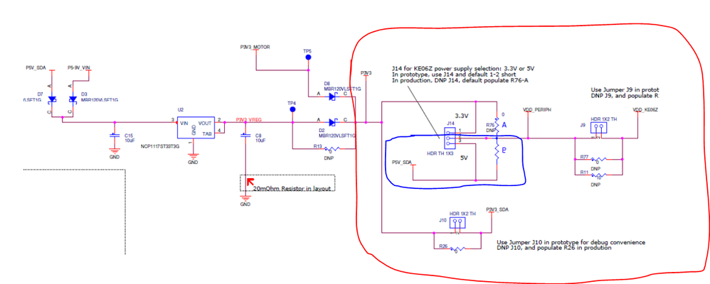

So I'm worried that only the 3.3V node will work for the bootloader to SWD.
I connected pins 2&3 on J14 of the FRDM board. I now have 5 Volts running to the board I am trying to program. However the bootloader now fails every time I try to upload my SREC file. It did work with the 3.3V for pins 1&2 of j14.
Here's the dilemma and we may just have to deal with this but I was hoping maybe you guys knew why the 5v wasn't working.
On the target MCU the Vdd node is tied to a 5 Volt regulator. And this is currently presumed to be causing the FRDM board to fail after awhile (usually after 30-40 uploads). I wanted to try to get the 5v working so there wouldn't be competing voltages at the same node. Does anyone have any material/information on this or is this thing not going to work with 5 Volts? It was hard to determine from the ke06z user guide.

   Please note, in the FRDM-KE06 board, the on board debugger is the K20 chip, this chip just the 3.3V chip, can't work with 5V.
  So, it means your debug SWD interface still 5V, not 3.3V, maybe this caused the unstable issues.
So, I think you can use the 3.3V to download the code, then check your code function with 5V.
Or another way, you can use the external debugger which can support 5V, just don't use the on board debugger.

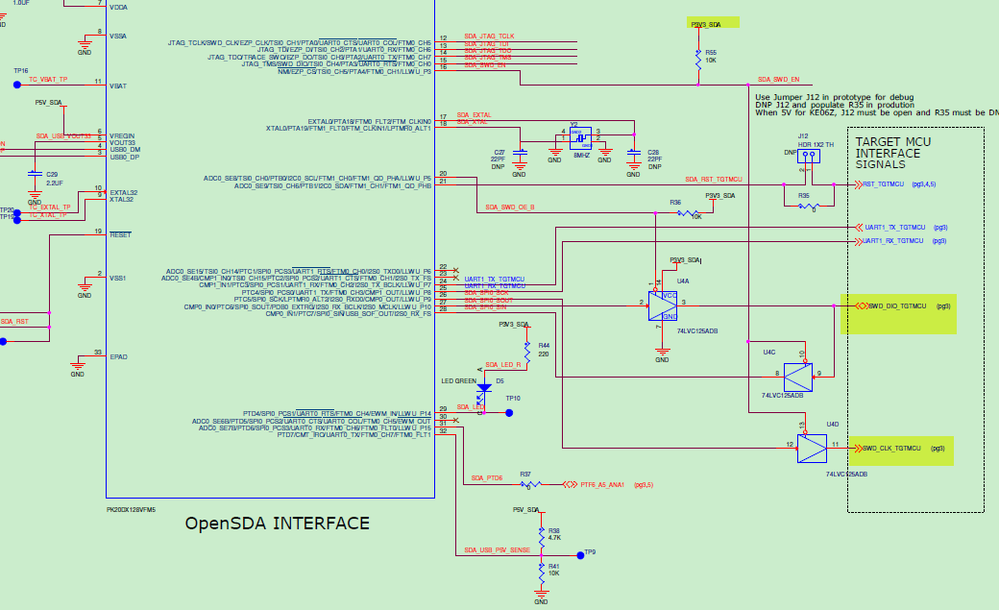

We were wondering if it's possible to use a logic shifter to program the target board? We would take the 3.3v output from the Freedom board. We would send it into a logic shifter. From the logic shifter we would attempt to program our target board with the 5v?

   So, if you want to match the 3.3V to 5V, I suggest you use the logic shifter to transfer the 3.3V to 5V or 5V to 3.3V, to keep the debugger working stably.

So we attempted to use the logic level shifter to bring it from 3.3V to 5V. The bootloader fails and does the 3 blinks at a time. I took all the signals in and out of the shifter. We are using a CD40109B shifter. Do you have any potential suggestions... I can post the circuit too if you prefer and might have an idea
I essentially tie all the enables to the 3.3
Then feed the SDA, SCL, Reset through the shifter. Have the output powered by 5v and thats it

  Please share your CD40109B related circuit.
  Do you check the each side voltage, whether it is correct when send the datas?

Also It does appear that I am getting signals through the shifter
