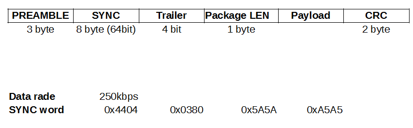

I would like to communicate with LT8920 chip:
https://www.deviationtx.com/media/kunena/attachments/7714/LT8920datasheetEngversion201701191.pdf
It's a 2.4GHz GFSK radio, with frame look like that:
Is it possible to set something like that?
I checked documentation of KW36 and for example maximum SYNC lenght is 32bit.
So maybe is possible to receive GFSK data not in packets? Like RAW data, like sniffer?
If yes, how to do that?

There's a GFSK stack macro defined as gGenfskRawPacket which changes the packet type to transmit and receive information using a "RAW" format, instead of the regularly formatted GFSK packets. These have a maximum size of 35 bytes, which can contain the whole frame you describe. As an important note, the maxBufLengthBytes size for the Rx modes has to be set exactly to the size of the packet you're receiving, otherwise, it will be rejected.
There's also the MSK radio mode, which also bypasses all hardware acceleration, and allows for a maximum packet size of 35 bytes.

So, in RAW mode I load info buffer the whole frame with the preamble etc. ? The same situation when i receive data, in buffer I will find preamble, data, crc etc?
I'm worried about info:
"maxBufLengthBytes size for the Rx modes has to be set exactly to the size of the packet you're receiving, otherwise, it will be rejected."
Does it mean that I need to know exactly what frame length I should expect?
If I set frame too long, will it also be rejected? Will not be filled with 0, 1 or random data (noise)?
If yes, I think the main problem can be with TRAILER in LT8920, because it have only 4bit, so whole frame have for example 22 bytes and 4 bits. Then MK36 radio cannot receive it?

To my understanding, the 4bit trailer should be considered a full byte for the buffer size calculation so that it doesn't get rejected.
As another thing of note, according to section 6.1.1, the preamble and address size do not count against the 35 bytes allowed for RAW mode Rx and Tx.
With these considerations in mind, the KW36 should be able to receive the RAW packages.
