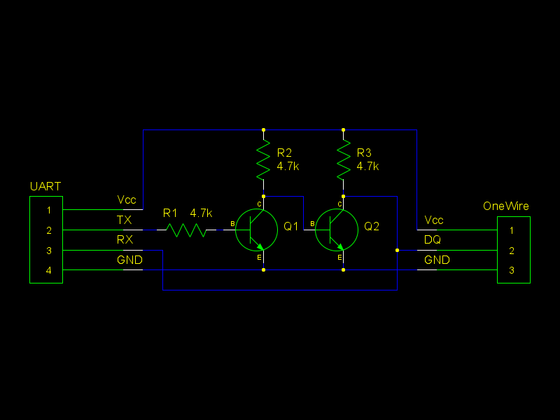

There is some AN or example aobut 1Wire UART circuit for Kinetis?

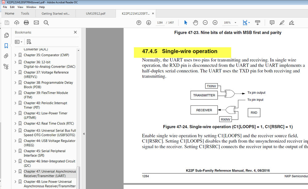

kerryzhou
Hi Javier Hernandez ,
  Please tell me which kinetis chip you are using? Tell me the chip part number, I will help you to check whether that chip can support the single wire UART or not.
Some kinetis chips UART module can support the single-wire operation, about the document, you can refer to the chip reference manual directly.
Take K22 chip as ane example:
You also can check your kinetis chip reference manual by yourself.
Wish it helps you!
Kerry

kerryzhou
Hi Javier Hernandez,
    Thank you for your updated information.
    So, please refer to the KL05 reference manual, chapter:
   37.3.4.3 Single-wire operation
  This chip UART0 also support the single-wire operation.
Wish it helps you!
Kerry

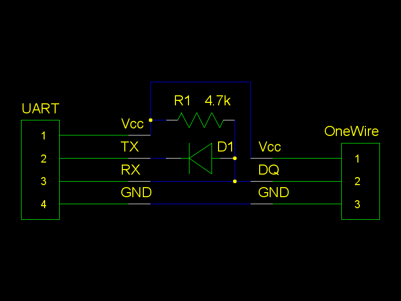

jhd
Sorry Kerry,
In KL03 Reference Manual say that KL03 has open-drain in uart so is possible to 1-wire, but KL03 has not DMA module, I think.
ISO7816 protocol is intended to be handled in software for this product. To support smart card readi...
This circuits should be works:
4,409 Views
jhd
Perfect!
