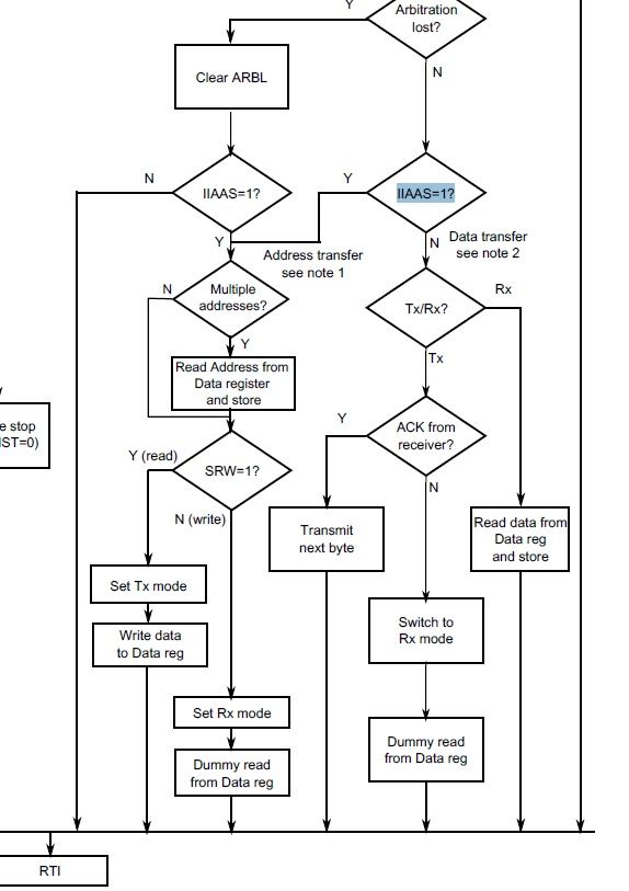

Here is the code for the slave initialization and interrupt handler.
This interrupt handler follows the slave path in the flowchart provided in the operators manual.

The following waveforms are a slave write (left) and slave read (right).  The slave address is 0b0000000001.
From reference manual:
3,033 次查看
kerryzhou
Hi Johanna Gunter,
    Please check the KL03 reference manual, chapter 35.5.2 10-bit address at first, did you meet the 10bit address table? please also check your I2C bus data.
Please make sure you meet this table.
