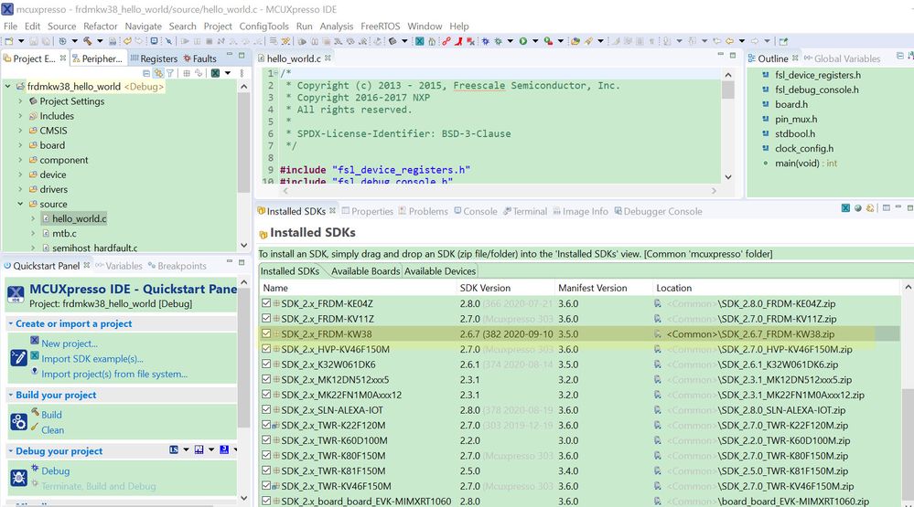

kerryzhou
Hi notanivipul,
  That's really a little strange, you are using the same IDE version as me.
   What's the SDK version you are using? SDK2.6.7?
   Please check this picture:

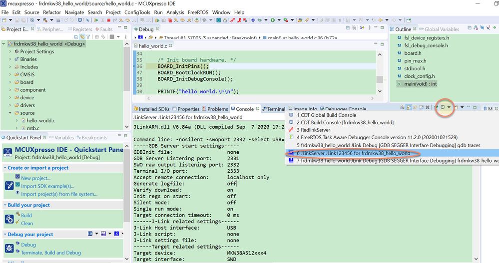

When you import the SDK project, please use the UART instead of the console, then try it again.
If you still have download issue, please also give me your MCUXPresso JLINK debug log, you can find the log like my attached picture:
You can find my log in the attachment, you also can compare your own log with my log.

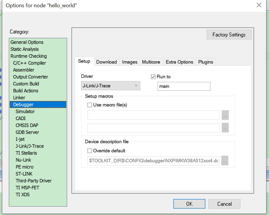

Except MCUXPresso IDE, do you have any other IDE, eg, IAR
The following picture is my IAR project test result, as you know, the SDK also contains the IAR project.

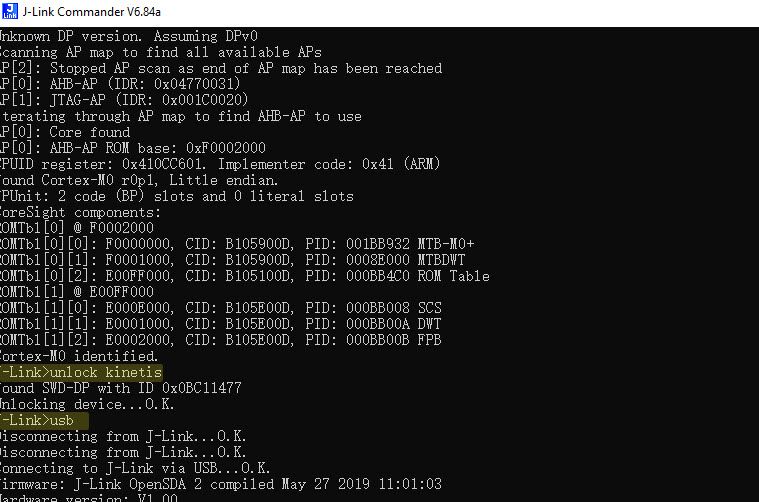

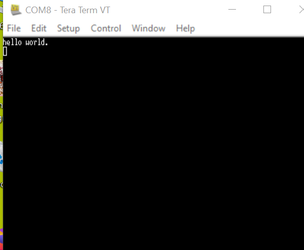

We still have another way, you can download the code without the IDE, we can use the JLINK commander to download the app firmware .bin file directly.
Before you download the code, you can also erase it.
1. Connect the board, and find the arm core
2. use commander: unlock kinetis
to erase all the chip flash
3. commander: usb
to reconnect the chip, and find the ARM core
4. copy my attached frdmkw38_hello_world.bin to the JLINK install path:
C:\Program Files (x86)\SEGGER\JLink
5. use commander: loaderfile frdmkw38_hello_world.bin
You will find the app.bin is downloaded, please check my attached picture.

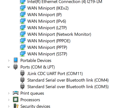

53,619件の閲覧回数
kerryzhou
Hi notanivipul,
    After you connect the FRDM-KW38 to your PC, please check the control panel:
Control Panel\Hardware and Sound\Devices and Printers
 Can you find the CMSIS DAP?
Please check my side result:
So, you need to check your on board debugger at first.

53,610件の閲覧回数
notanivipul
Hi @kerryzhou
Thanks for your reply.
I can find CMSIS DAP in my control panel devices.

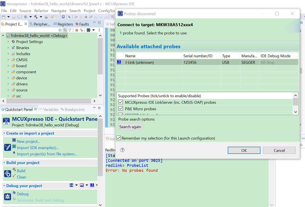

53,572件の閲覧回数

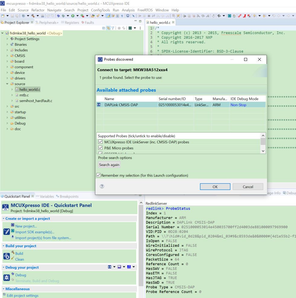

notanivipul
Hi @kerryzhou
Yes I am using MCUXPresso IDE for frdmkw38 board.
I have attached the screenshots of steps that i am Following, please check if you can find the issues .
Please let me know if you need screenshot of any specific step or any other information.
Thanks and regards
Vipul

kerryzhou
Hi notanivipul
  img3.PNG is also from your side?
  That can find the DAPLink CMSIS-DAP.
   If it is not your picture, please just img4.PNG is yours.
   Then, please delete the frdmkw38_gpio_led_output_1 LinkServer Debug.launch, clean the project, and debug it again.

53,557件の閲覧回数

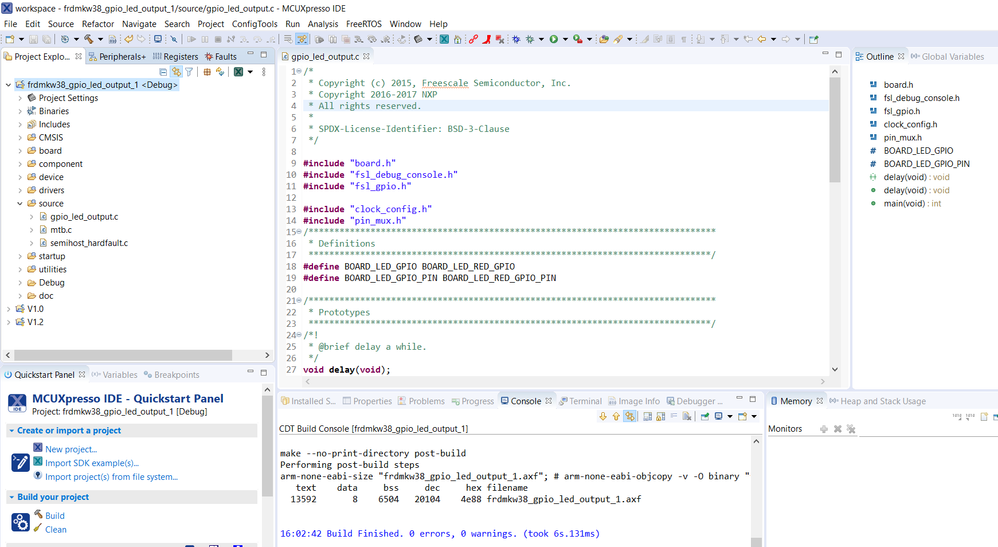

notanivipul
Hi @kerryzhou
Yes, img3.PNG is from my side.
I deleted frdmkw38_gpio_led_output_1 LinkServer Debug.launch as you said and and tried debug again after cleaning the project but I am still getting the same error.
Capture1.PNGCapture1.PNGCapture2.PNGCapture2.PNGCapture3.PNGCapture3.PNGCapture4.PNGCapture4.PNG

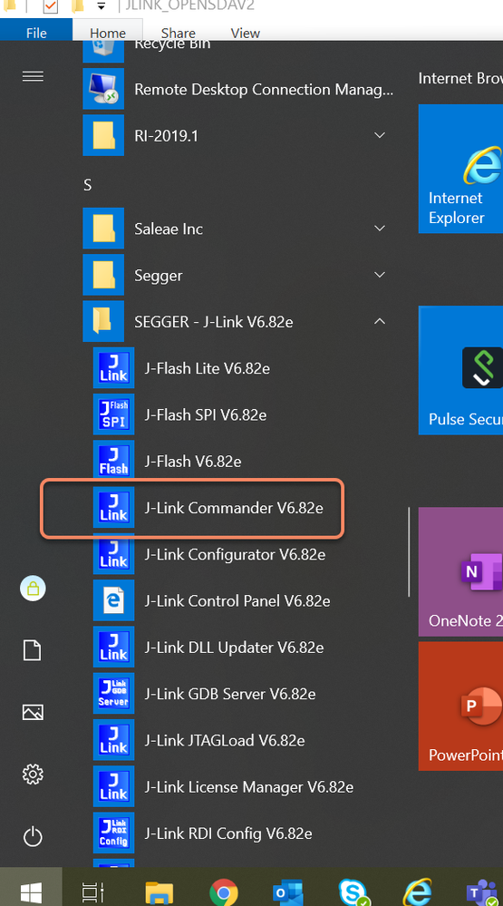

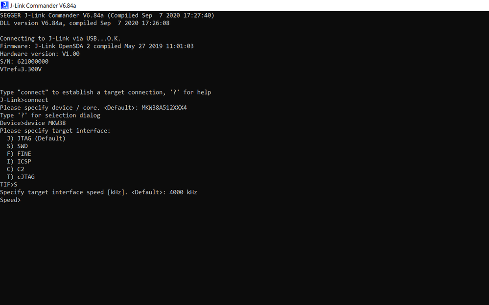

ok, now, open the JLINK commander from your PC start area, check the following picture and follow it:
Now, can you find the Cortex-M0 like me?
Please check it?
Then you can delete your .launch , and use the JLINK to download the code again.
You can find I also can use the JLINK to download code.

As mentioned I updated the onboard debugger to JLINK. Following are the screenshot and I am stuck where I have to enter the speed
Please let me know what steps are to be followed next.
Thanks and regards
Vipul
53,533件の閲覧回数
kerryzhou
Hi notanivipul
   Just press ENTER, use the default speed is OK.
Best Regards
Kerry

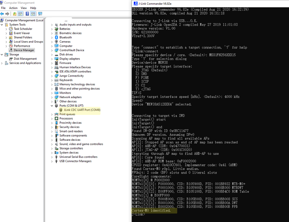

53,528件の閲覧回数
notanivipul
Hi @kerryzhou
I followed the steps as you suggested.
Following are the screenshots, but I am still unable to upload the code.
Please let me know what could be done next.
Thanks and regards
Vipul
53,508件の閲覧回数
kerryzhou
Hi notanivipul
  Your JLINK already can find the ARM core, that's strange you still can't use the MCUXPresso IDE to download.
  Please tell me your MCUXPress IDE version, do you use the newest version?
Kerry
