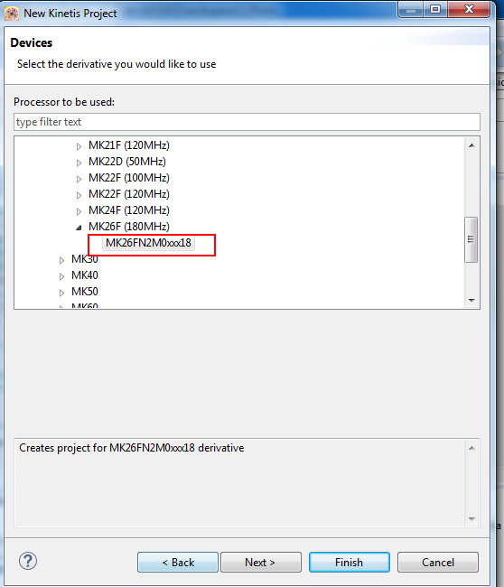

mike1974
When I go to Components Library -> Processors section of Processor Expert, I don't see support for the MK26 micro.  Is there something additional I need to install, or is it simply not supported?
Thank you,
Mike
2,148 Views
Hello Mike,

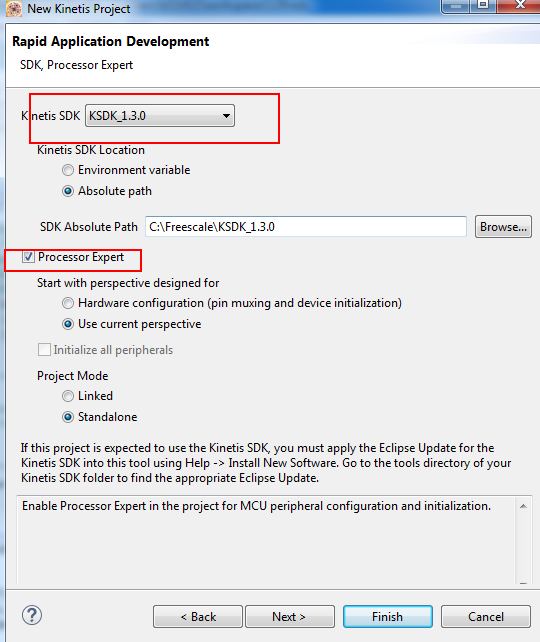

What about the part number about your chip, if you use MK26FN2M0xxx18, you can use
the KSDK1.3, in the kSDK+PE, we can select this chip :
About download and install the KSDK1.3, you can refer to here :
Now available: Kinetis SDK 1.3.0
Hope it helps
Alice

mike1974
That was the solution thank you Alice
