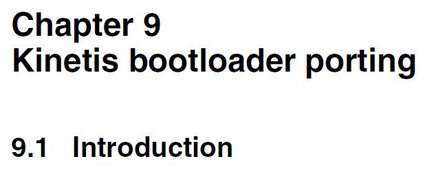

Hi Jayanth,
The KBOOT 1.2.0 allows the target device to upgrade the software through the UART, I2C,SPI, UART or USB HID.
As David mentioned above, the KBOOT hasn't provided the corresponding demo for KL26, however for KL25.
And I'd like to suggest that you can port this demo to KL26 through the steps that the attachment illustrates.
